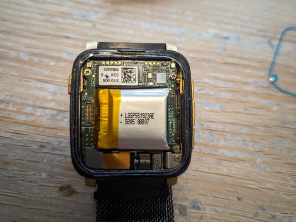

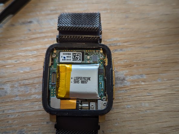

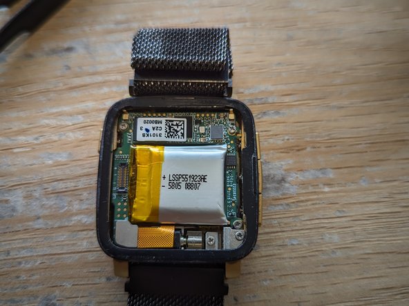

  13. Pebble Time Steel Battery Replacement, Battery: 13 단계, 이미지 1개 중 1개
    • After removing the circuit board, the battery is located in the middle of the case.

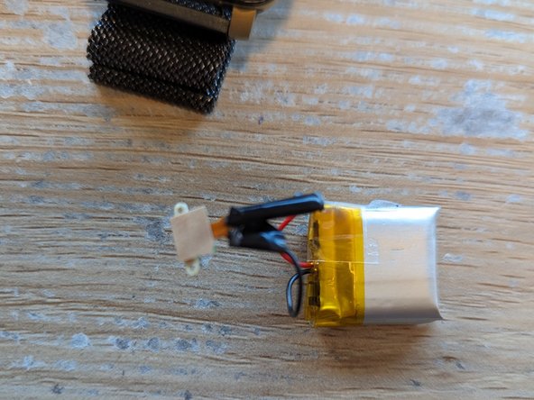

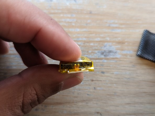

  16. Pebble Time Steel Battery Replacement, Battery Flex Cable: 16 단계, 이미지 2개 중 1개 Pebble Time Steel Battery Replacement, Battery Flex Cable: 16 단계, 이미지 2개 중 2개
    • The original battery (note my lovely swollen one here) has a special flex cable attached to it that's soldered onto the battery - if you're up for it, desoldering this cable is probably the cleanest/easiest way to install.
    • There are two contact points (second photo) in the middle that need to be de-soldered and re-soldered, and as you can see they are quite small and fiddly, and you don't want to bridge the two because they're connected to a live battery unfortunately.

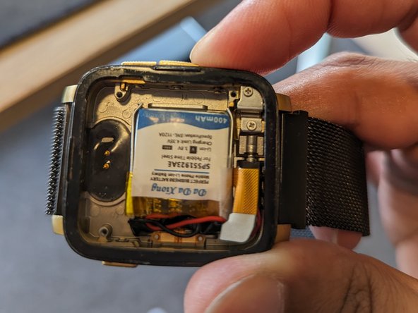

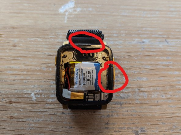

  17. Pebble Time Steel Battery Replacement, Trimming Battery Leads: 17 단계, 이미지 3개 중 1개 Pebble Time Steel Battery Replacement, Trimming Battery Leads: 17 단계, 이미지 3개 중 2개 Pebble Time Steel Battery Replacement, Trimming Battery Leads: 17 단계, 이미지 3개 중 3개
    • Something that I didn't do originally is to trim the battery leads - comparing the photos, you can see how much excess there is. This makes re-assembling the watch easier as there is less excess wire to tuck away and find space for.
    • I also didn't get a photo of the battery just on its own, to show just how long the leads are, but they're about 3 or 4cm I'd say. In terms of the length I ended up trimming them to, it was approximately 1 length of the top of the battery (the yellow taped portion in the last photo).
    • If you haven't potentially having a look at the Reddit thread linked in the Introduction is a good idea, as it gives you context for just how tight these batteries are to install, and how important selecting the right battery is, as well as knowing what you're getting yourself into!

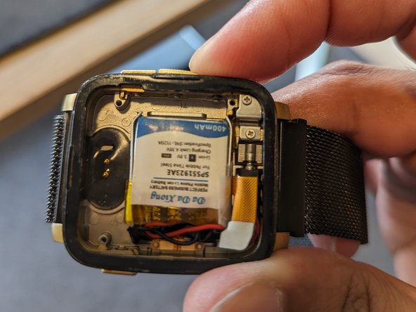

  21. Pebble Time Steel Battery Replacement, Put It Back Together: 21 단계, 이미지 2개 중 1개 Pebble Time Steel Battery Replacement, Put It Back Together: 21 단계, 이미지 2개 중 2개
    • Now it's time to put it all together - for the most part, you can go back up this guide and use the steps in the reverse order as standard, however since I had excess lead length, I found it easier to install the Battery Flex Cable, then to install the Motherboard, and finally to tuck away all the excess lead and install the battery.
    • With the excess lead, I tucked this in slightly underneath and parallel to the inner left edge of the motherboard (where the two ribbon connectors are). The battery still fits reasonably well, but as you can see there is quite a lot of excess to store. The other battery I installed (last photo) is much better in this respect, with thinner wires.

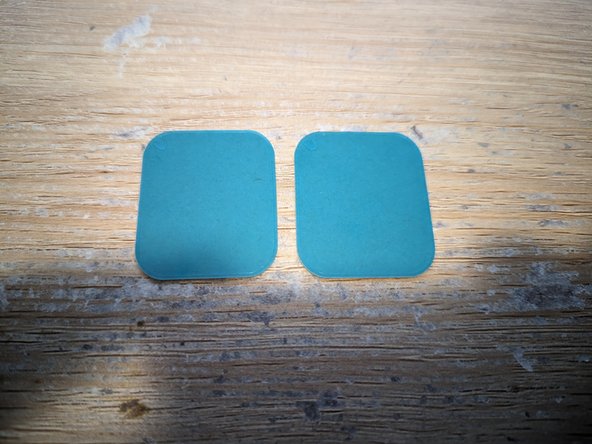

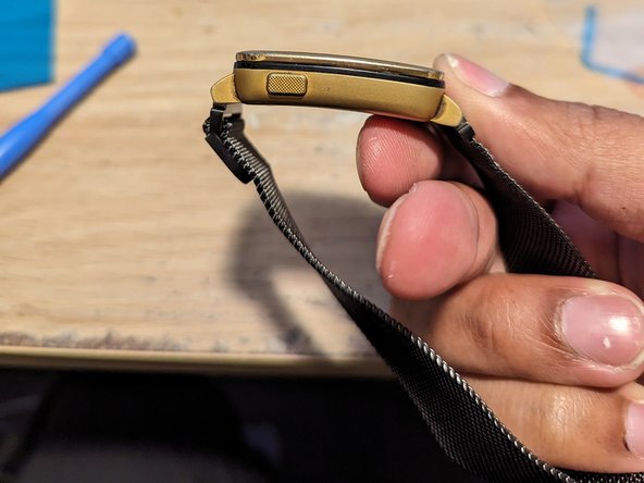

  23. Pebble Time Steel Battery Replacement, A Quick Note On Adhesives: 23 단계, 이미지 2개 중 1개 Pebble Time Steel Battery Replacement, A Quick Note On Adhesives: 23 단계, 이미지 2개 중 2개
    • This seems to be something most people struggle with - what to attach the screen back on with. Tesa Tape is a good option, otherwise in my first replacement I actually used a spare LCD Adhesive set I had lying around (refer to next step). My best idea was to use some Apple Watch Series 5 (44mm) adhesive, and cut it down.
    • One note is to not use the red heat-to-melt Apple Watch Adhesives (first photo), as this was my original plan, which unfortunately didn't work. I've found commonly the adhesives themselves don't actually say they're heat to melt, but you can tell from the colour.
    • Over the coming steps, I would highly recommend putting the adhesive on the main frame rather than the top cover, as it's much easier to align and get it in the right places. There are two nibs (top and right when looking down at the Pebble) that need to be adhesive free, as they clip into holes in the top cover for alignment.

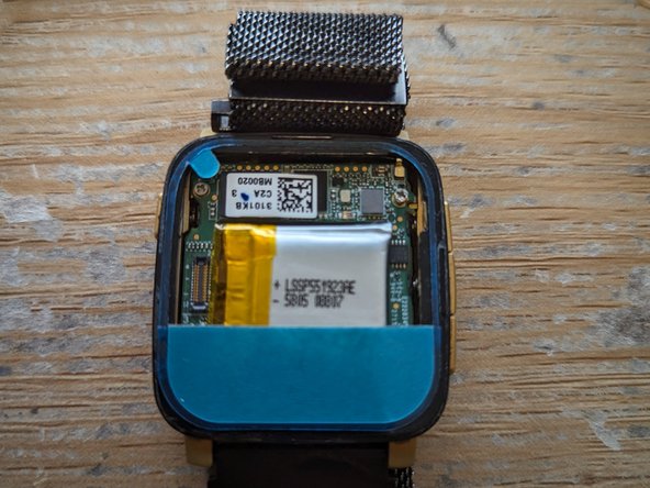

  24. Pebble Time Steel Battery Replacement, Option 1: DIY Tesa Method: 24 단계, 이미지 1개 중 1개
    • For this one, essentially you place and cut a guide using Tesa 61395 to make your own adhesive. Having just pulled apart another broken Pebble for parts, my guess is that the adhesive is perhaps 1mm thick, but then compressed down for a quality bond.
    • It's worth noting if you go down this route, take the time to acquire genuine Tesa Tape (61395) - the knock-offs are nowhere near as good, and Pre-Cut Adhesive also doesn't really hold up the same way either. In essence, nothing else compares!
  25. Pebble Time Steel Battery Replacement, Option 2: Apple Watch S5 (44mm) Adhesive Method: 25 단계, 이미지 3개 중 1개 Pebble Time Steel Battery Replacement, Option 2: Apple Watch S5 (44mm) Adhesive Method: 25 단계, 이미지 3개 중 2개 Pebble Time Steel Battery Replacement, Option 2: Apple Watch S5 (44mm) Adhesive Method: 25 단계, 이미지 3개 중 3개
    • Here's what I ended up using on my last re-assembly (30 mins ago as of writing this). This Apple Watch S5 (44mm) adhesive is pre-cut, and fits the corners of the PTS reasonably well. It is however a bit long, so I cut it about 3/4 down, applied the top half, and then cut the bottom half to size and applied it to meet flush.
    • It's also worth noting that this adhesive is quite thin, and needs to be triple-stacked to make contact with the top frame. I found two was too thin, whilst four was too thick! Fortunately, they come in packs of 5.
