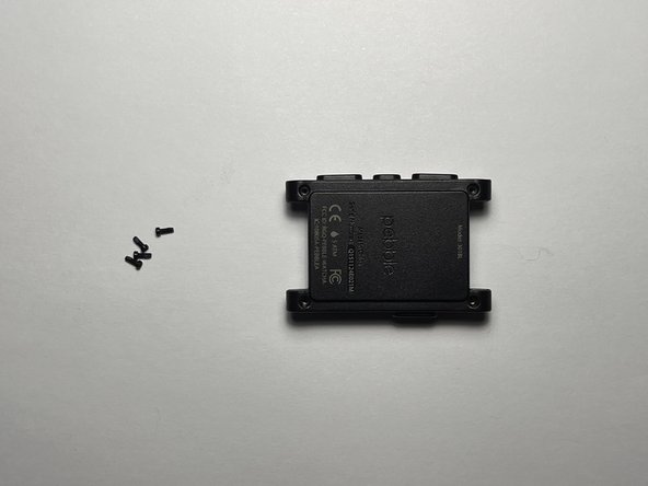

    3. Pebble battery Replacement, Remove the torx screws: 3 단계, 이미지 2개 중 1개 Pebble battery Replacement, Remove the torx screws: 3 단계, 이미지 2개 중 2개
      • Remove the four T4 torx screws

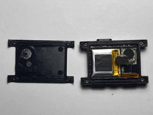

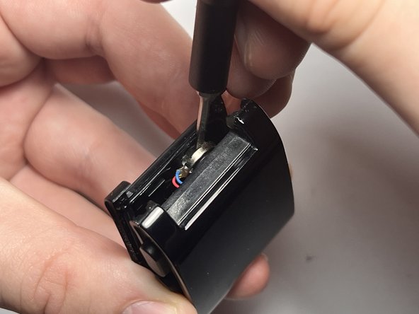

    5. Pebble battery Replacement, Separate haptic component from back: 5 단계, 이미지 3개 중 1개 Pebble battery Replacement, Separate haptic component from back: 5 단계, 이미지 3개 중 2개 Pebble battery Replacement, Separate haptic component from back: 5 단계, 이미지 3개 중 3개
      • There is one component glued to the back of the watch. Use a small flathead or a similar tool to pry it from the back of the watch.
      • During re-assembly, ensure the haptic component is fitted into its original position.

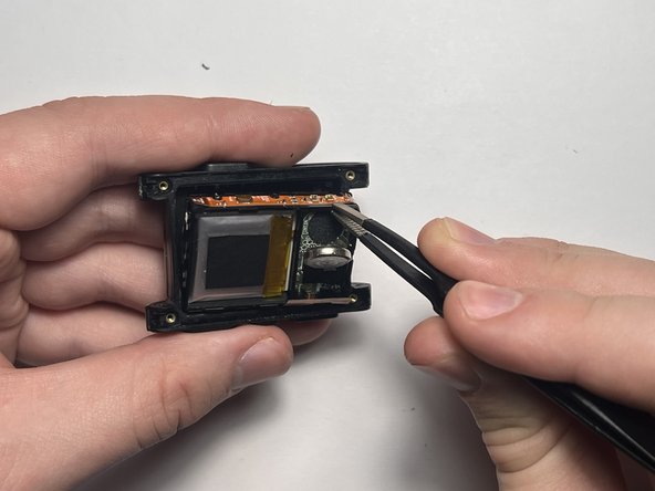

    6. Pebble battery Replacement, Remove internals: 6 단계, 이미지 3개 중 1개 Pebble battery Replacement, Remove internals: 6 단계, 이미지 3개 중 2개 Pebble battery Replacement, Remove internals: 6 단계, 이미지 3개 중 3개
      • The internals of the watch lie inside a plastic housing which can be disconnected from the screen. This is more difficult for some watches than others. Use a pair of tweezers that have a good grip.

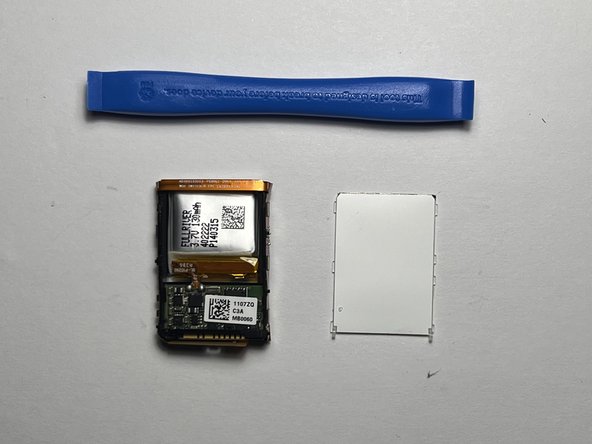

    7. Pebble battery Replacement, Remove light shield: 7 단계, 이미지 3개 중 1개 Pebble battery Replacement, Remove light shield: 7 단계, 이미지 3개 중 2개 Pebble battery Replacement, Remove light shield: 7 단계, 이미지 3개 중 3개
      • Using tweezers or fingers, carefully remove the black film from the side with the white light diffuser. Set it aside to be reapplied during reassembly.
      댓글 쓰기
    8. Pebble battery Replacement, Remove light diffuser: 8 단계, 이미지 3개 중 1개 Pebble battery Replacement, Remove light diffuser: 8 단계, 이미지 3개 중 2개 Pebble battery Replacement, Remove light diffuser: 8 단계, 이미지 3개 중 3개
      • Using a prying tool, separate the diffuser from the casing via the small plastic hooks.
      • This can take a decent amount of force, but take it slow. excessive bending can crack the diffusion material between the two white plastic sheets.

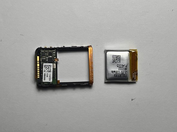

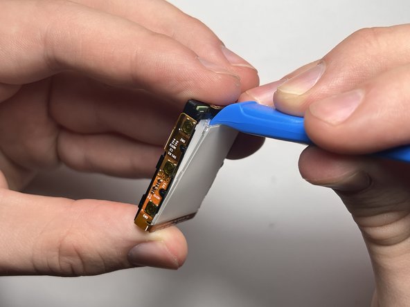

    9. Pebble battery Replacement, Remove battery: 9 단계, 이미지 2개 중 1개 Pebble battery Replacement, Remove battery: 9 단계, 이미지 2개 중 2개
      • Using scissors or a small blade, carefully cut the ribbon cable connecting the battery to the main board.
      • Take caution as to not puncture the battery. Doing so could result in an explosion or fire.

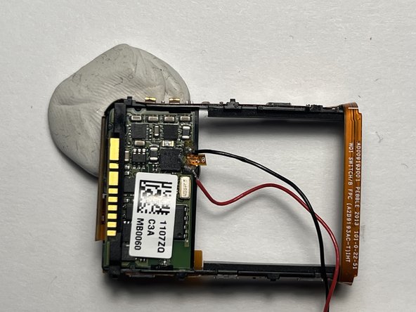

    11. Pebble battery Replacement, Solder the black wire: 11 단계, 이미지 2개 중 1개 Pebble battery Replacement, Solder the black wire: 11 단계, 이미지 2개 중 2개
      • Using soldering iron and a pair of precision tweezers, solder the black wire of your replacement battery to the contact shown in the picture. The pre-applied solder should be sufficient for this, but more can be applied if necessary.
      • Using some kind of putty makes this much easier.
      • Soldering Iron temp around 340° C should be sufficient.
      댓글 쓰기
    12. Pebble battery Replacement, Solder the red wire: 12 단계, 이미지 2개 중 1개 Pebble battery Replacement, Solder the red wire: 12 단계, 이미지 2개 중 2개
      • Just like with step 11, use a soldering iron and a pair of precision tweezers to solder the red wire of your replacement battery to the contact shown in the picture. The pre-applied solder should be sufficient for this, but more can be applied if necessary.
      • After successfully soldering these wires, you should see the backlight light up

Make sure to pull the internals out by the up/down side closest to the battery (not the vibrator) or you'll crack the mount like I did, which might lead to screen tearing.
