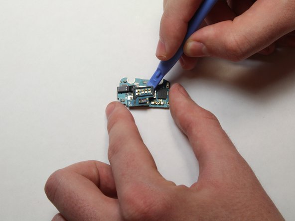

    1. Samsung Gear Live Heart Rate Monitor Replacement, Remove the heart rate sensor cable: 12 단계, 이미지 2개 중 1개 Samsung Gear Live Heart Rate Monitor Replacement, Remove the heart rate sensor cable: 12 단계, 이미지 2개 중 2개
      • Set the motherboard on a flat, stable surface.
      • Using the plastic opening tool, gently pry the heart rate sensor cable from the motherboard.
      댓글 쓰기
