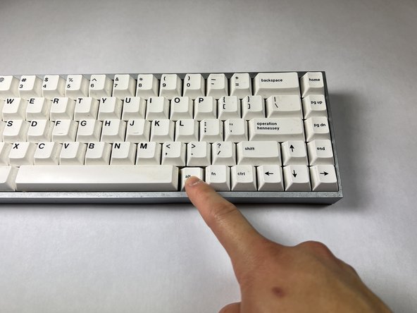

    2. Tofu65 Key Switch Replacement: 2 단계, 이미지 1개 중 1개
      • Remove the keycap by using a dedicated keycap remover or creating a hook-like tool with paperclips or using other tools.
      • Ensure that you pull it straight up without damaging the switch.
      댓글 쓰기

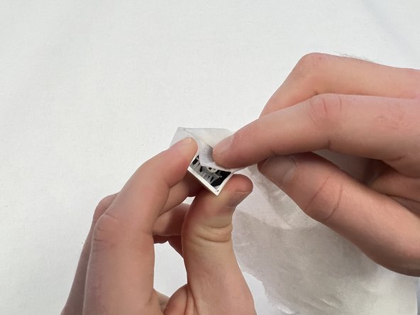

    3. Tofu65 Key Switch Replacement: 3 단계, 이미지 2개 중 1개 Tofu65 Key Switch Replacement: 3 단계, 이미지 2개 중 2개
      • Clean the keycap either by swabbing the inside and outside with a wet cotton swab or submerging the keycap in a small container with warm water for 30 minutes.
      • Hand/dish soap can be used as well but not necessary.
      • Dry the keycaps.
      • DO NOT leave the keycaps in sunlight or else they could warp.

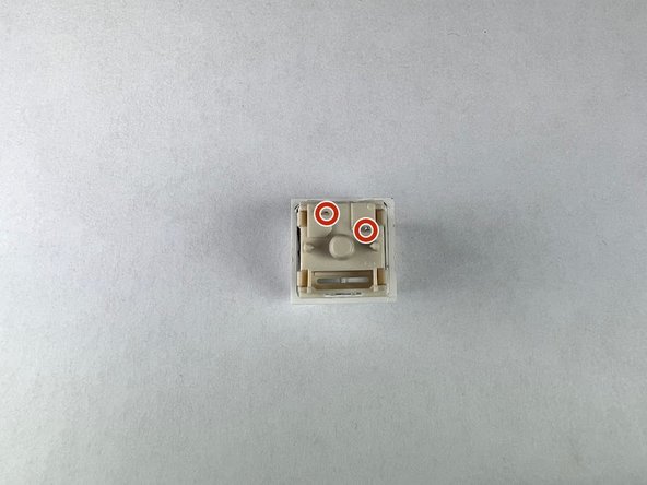

    4. Tofu65 Key Switch Replacement: 4 단계, 이미지 1개 중 1개
      • In order to remove the switch, locate the two switch housing pins near the top and bottom of the switch that hold it in the keyboard plate.
