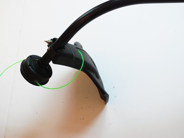

Weed Whacker Line Replacement
  1. Weed Whacker Line Replacement, Line: 1 단계, 이미지 3개 중 1개 Weed Whacker Line Replacement, Line: 1 단계, 이미지 3개 중 2개 Weed Whacker Line Replacement, Line: 1 단계, 이미지 3개 중 3개
    • Remove cutting line guard from weed whacker. This is usually attached by a wing-nut or a bolt and nut, so it can be removed either by hand or with the correct sized wrench.

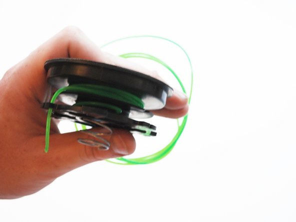

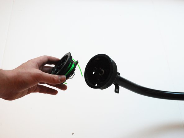

  4. Weed Whacker Line Replacement: 4 단계, 이미지 2개 중 1개 Weed Whacker Line Replacement: 4 단계, 이미지 2개 중 2개
    • Once the bottom piece is removed, there will be another circular piece that may or may not have cutting line coiled around it. Remove this piece from the weed whacker.

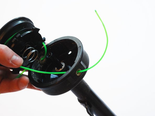

  5. Weed Whacker Line Replacement: 5 단계, 이미지 2개 중 1개 Weed Whacker Line Replacement: 5 단계, 이미지 2개 중 2개
    • There should be slots to coil cutting line around, with a hole in each for line to be anchored. If no line is coiled around the part, insert the end of about three feet of cutting line into each of the holes, and coil the cutting line snugly around the part, making sure that there are no tangles in the line.
