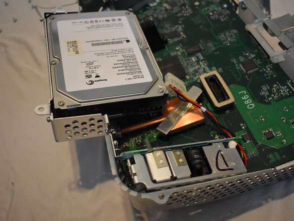

    1. eMac Hard Drive Replacement, Power Cable: 17 단계, 이미지 2개 중 1개 eMac Hard Drive Replacement, Power Cable: 17 단계, 이미지 2개 중 2개
      • Disconnect the 4-pin hard drive power connector.
      댓글 쓰기
    2. eMac Hard Drive Replacement, Caddy Screws: 18 단계, 이미지 1개 중 1개
      • The hard drive is fastened to a caddy. In order to remove it, the caddy must be removed first.
      • It is secured to the motherboard assembly with two phillips #2 screws. Remove them, but don't pull the drive out yet.
      댓글 쓰기
    3. eMac Hard Drive Replacement, IDE Cable: 19 단계, 이미지 2개 중 1개 eMac Hard Drive Replacement, IDE Cable: 19 단계, 이미지 2개 중 2개
      • The drive is still connected with an IDE cable, which is folded under the caddy.
      • Disconnect the IDE cable from the motherboard, and lift the drive caddy out.
      댓글 쓰기
    4. eMac Hard Drive Replacement, Drive Screws: 20 단계, 이미지 3개 중 1개 eMac Hard Drive Replacement, Drive Screws: 20 단계, 이미지 3개 중 2개 eMac Hard Drive Replacement, Drive Screws: 20 단계, 이미지 3개 중 3개
      • The hard drive is held in the caddy with four phillips screws. Remove them.
      • Also disconnect the IDE cable from the drive. It can now be removed from the caddy.
      댓글 쓰기
