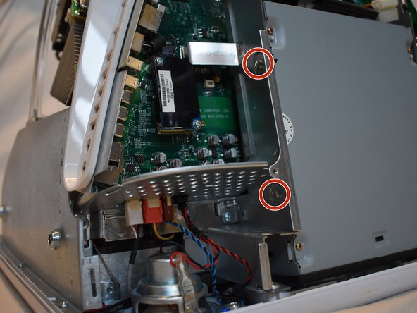

    2. eMac Optical Drive Removal, Screw Removal: 8 단계, 이미지 2개 중 1개 eMac Optical Drive Removal, Screw Removal: 8 단계, 이미지 2개 중 2개
      • The drive is held in by two phillips #2 screws on each side. Remove these.
