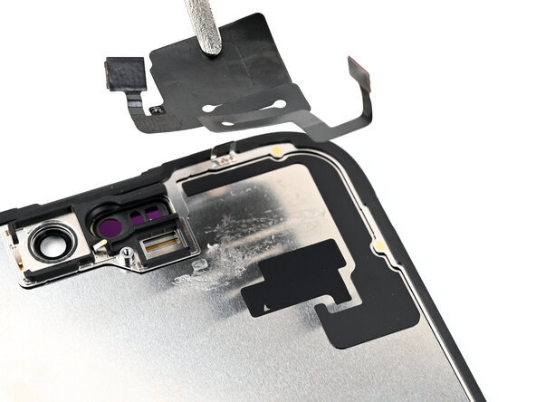

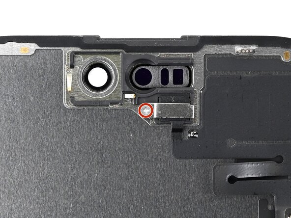

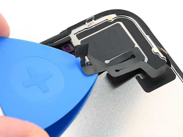

  20. iPhone 16 Plus Screen Replacement, Remove the ambient light sensor bracket: 20 단계, 이미지 3개 중 1개 iPhone 16 Plus Screen Replacement, Remove the ambient light sensor bracket: 20 단계, 이미지 3개 중 2개 iPhone 16 Plus Screen Replacement, Remove the ambient light sensor bracket: 20 단계, 이미지 3개 중 3개
    • Use a Phillips screwdriver to remove the 1.3 mm‑long screw securing the ambient light sensor bracket.
    • Use a pair of tweezers or your fingers to lift and remove the ambient light sensor bracket.

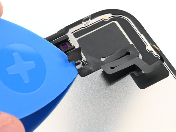

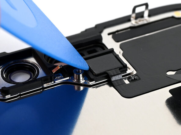

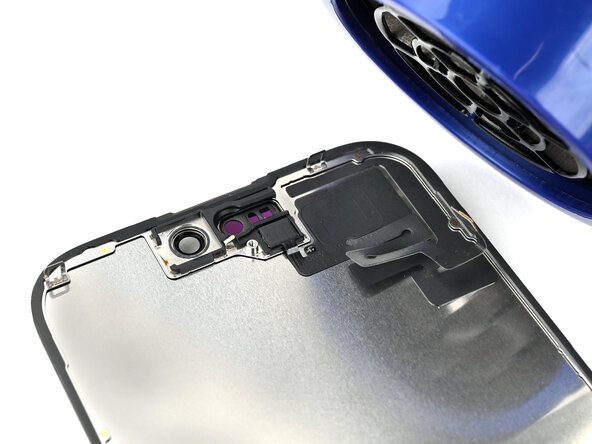

  21. iPhone 16 Plus Screen Replacement, Pry up the ambient light sensor: 21 단계, 이미지 3개 중 1개 iPhone 16 Plus Screen Replacement, Pry up the ambient light sensor: 21 단계, 이미지 3개 중 2개 iPhone 16 Plus Screen Replacement, Pry up the ambient light sensor: 21 단계, 이미지 3개 중 3개
    • Use a hair dryer, heat gun, or heated iOpener to soften the adhesive under the ambient light sensor and ambient light sensor cable.
    • Use an opening pick to pry up the ambient light sensor.

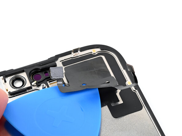

  22. iPhone 16 Plus Screen Replacement, Peel up the ambient light sensor cable: 22 단계, 이미지 2개 중 1개 iPhone 16 Plus Screen Replacement, Peel up the ambient light sensor cable: 22 단계, 이미지 2개 중 2개
    • Gently slide an opening pick under the ambient light sensor cable, starting near the sensor and moving towards to the opposite corner.
    • If the adhesive doesn't peel up easily, apply more heat.

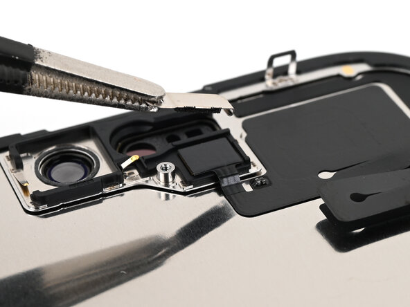

  23. iPhone 16 Plus Screen Replacement, Remove the ambient light sensor: 23 단계, 이미지 3개 중 1개 iPhone 16 Plus Screen Replacement, Remove the ambient light sensor: 23 단계, 이미지 3개 중 2개 iPhone 16 Plus Screen Replacement, Remove the ambient light sensor: 23 단계, 이미지 3개 중 3개
    • Continue slowly sliding the opening pick under the ambient light sensor cable until the cable is free from the screen.
    • Use a pair of tweezers to lift the ambient light sensor off of the screen.
  24. iPhone 16 Plus Screen Replacement, Disassembly complete: 24 단계, 이미지 1개 중 1개
    • Congratulations on completing disassembly! The remaining steps will show how to reassemble your iPhone.
    • Some reassembly photos are of the iPhone 16 non‑Plus, which may look slightly different. The procedure is correct.
