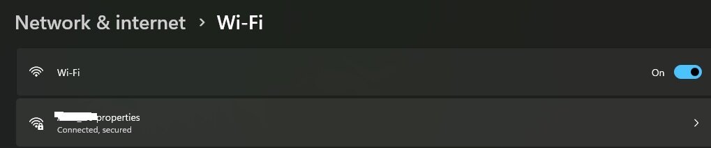

Thanks koppie007 for the reply! To clarify, I’m actually referring to internet data usage (bandwidth) rather than storage space. As a student, it’s really frustrating because my monthly subscription keeps running out before the end of the month, even when I'm not doing much. I’m looking for ways to track which apps are eating my data in the background and how to stop them.

A lot of it is likely Windows 11 - I'm assuming it's on W11 becuase the G8 has the "right" processor (Ryzen 4000) and HP shipped them with it for that series as I know from my 640 G9, 645 G11 and 6 G1a. Win11 is infamous for data usage :-(. It killed my 15GB data plan on vacation real quick with the usage and the telemetry that still gets through.
O&O SU10 tames a lot of it (and my God, even on a non metered connection, Microslop has way too much), but you can also "meter" the connection to delay the Windows Updates and help it that way:
