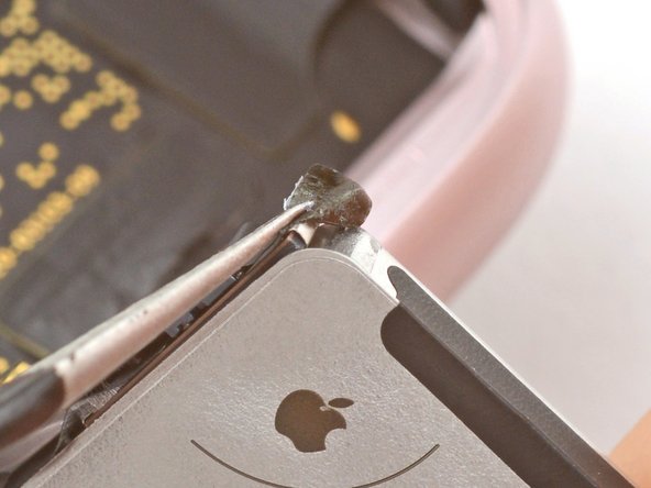

  17. Apple Watch Series 9 (41mm) Battery Replacement, Remove the battery cable tape: 17 단계, 이미지 3개 중 1개 Apple Watch Series 9 (41mm) Battery Replacement, Remove the battery cable tape: 17 단계, 이미지 3개 중 2개 Apple Watch Series 9 (41mm) Battery Replacement, Remove the battery cable tape: 17 단계, 이미지 3개 중 3개
    이 단계에 사용된 도구:
    $3.99
    • Even though the Series 9 battery is encased in metal, be careful with sharp tools—a punctured battery may leak dangerous chemicals or cause a fire.
    • Use one arm of angled tweezers to gently lift the tape from the top right corner of the battery.

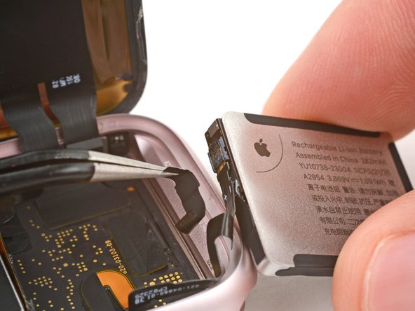

  18. Apple Watch Series 9 (41mm) Battery Replacement: 18 단계, 이미지 2개 중 1개 Apple Watch Series 9 (41mm) Battery Replacement: 18 단계, 이미지 2개 중 2개
    • Use tweezers to remove the tape from the left edge of the battery.

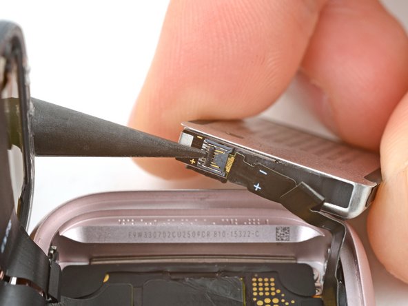

  20. Apple Watch Series 9 (41mm) Battery Replacement, Disconnect the battery: 20 단계, 이미지 2개 중 1개 Apple Watch Series 9 (41mm) Battery Replacement, Disconnect the battery: 20 단계, 이미지 2개 중 2개
    • Use the point of a spudger to lift the small, hinged locking flap on the battery ZIF connector.

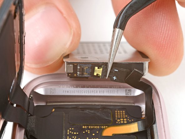

  21. Apple Watch Series 9 (41mm) Battery Replacement: 21 단계, 이미지 2개 중 1개 Apple Watch Series 9 (41mm) Battery Replacement: 21 단계, 이미지 2개 중 2개
    • Use tweezers to pull the battery cable straight out of its socket.

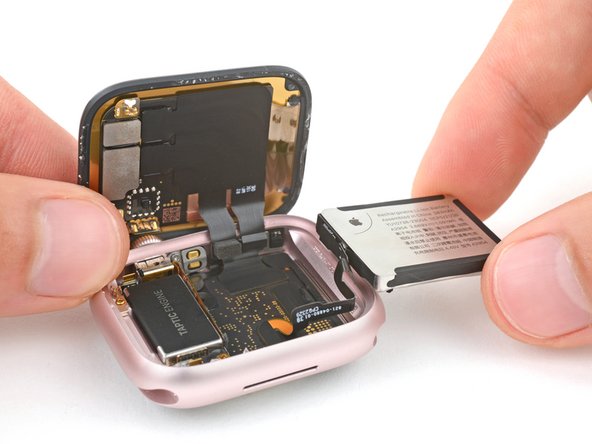

  22. Apple Watch Series 9 (41mm) Battery Replacement, Remove the battery: 22 단계, 이미지 1개 중 1개
    이 단계에 사용된 도구:
    Tesa 61395 Tape
    $5.99
    • Remove the battery.
