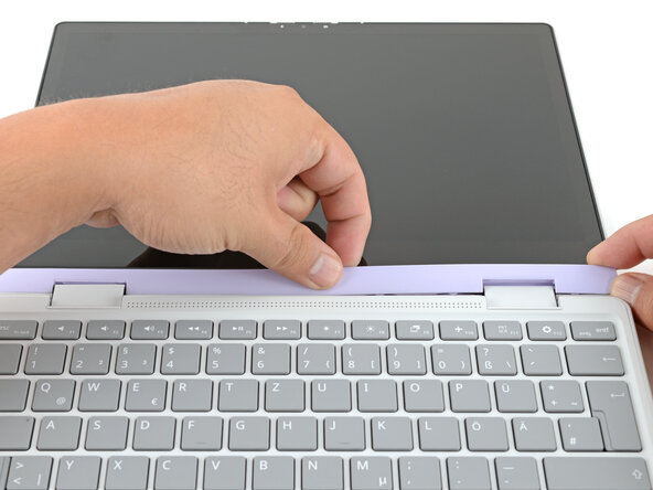

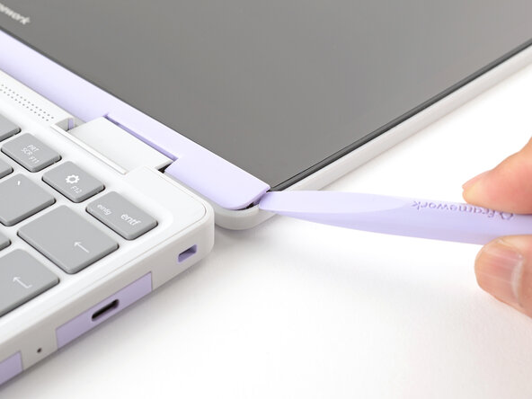

  3. Framework Laptop 12 Display Replacement, Remove the Display Cover: 3 단계, 이미지 2개 중 1개 Framework Laptop 12 Display Replacement, Remove the Display Cover: 3 단계, 이미지 2개 중 2개
    • The Display Cover is held in place with magnets along the top edge and clips along the remaining edges.
    • Use the flat end of your Framework Screwdriver to pry up the right edge of the Display Cover.
    댓글 쓰기

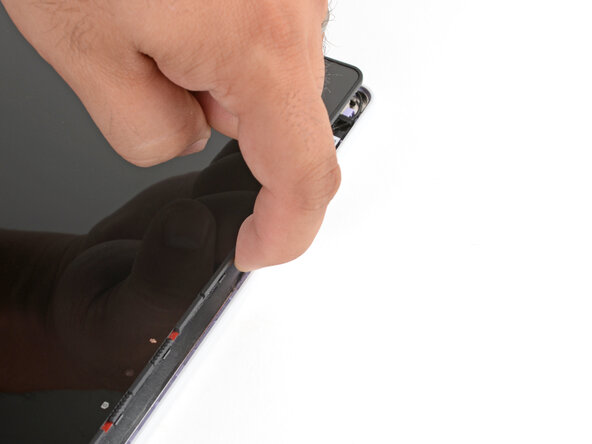

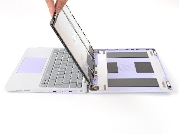

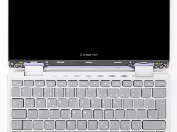

  8. Framework Laptop 12 Display Replacement, Lift the display: 8 단계, 이미지 2개 중 1개 Framework Laptop 12 Display Replacement, Lift the display: 8 단계, 이미지 2개 중 2개
    • Use your fingers to lift the top edge of the display from the Top Cover.
    댓글 쓰기

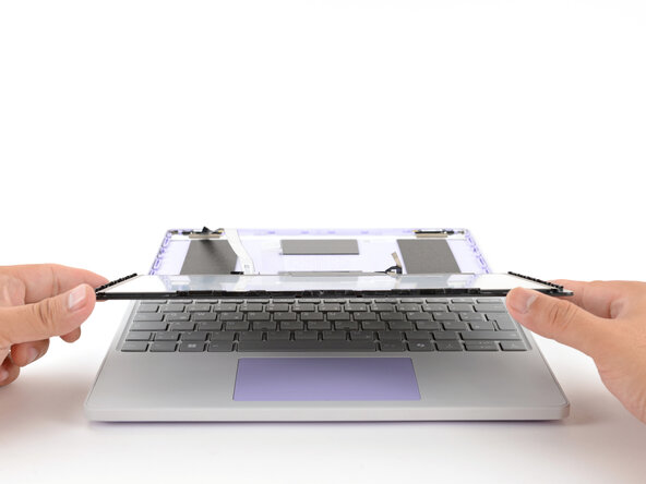

  9. Framework Laptop 12 Display Replacement, Swing the display over: 9 단계, 이미지 3개 중 1개 Framework Laptop 12 Display Replacement, Swing the display over: 9 단계, 이미지 3개 중 2개 Framework Laptop 12 Display Replacement, Swing the display over: 9 단계, 이미지 3개 중 3개
    • Use your fingers to carefully swing the display over so it lies on top of the keyboard.

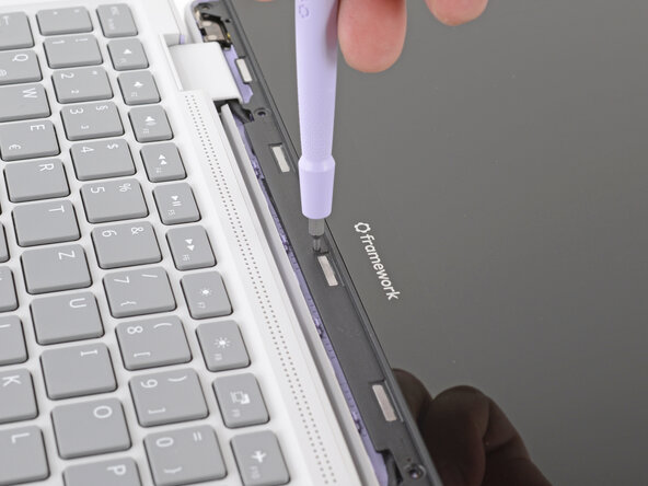

  10. Framework Laptop 12 Display Replacement, Remove the webcam bracket: 10 단계, 이미지 1개 중 1개
    • Use your Framework Screwdriver to remove the two 3.3 mm‑long T5 Torx screws securing the webcam bracket on the top edge behind the display.
    • These screws are not captive. Store them in a safe location for reassembly.

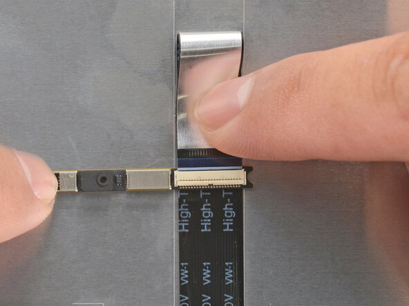

  12. Framework Laptop 12 Display Replacement, Disconnect the webcam: 12 단계, 이미지 3개 중 1개 Framework Laptop 12 Display Replacement, Disconnect the webcam: 12 단계, 이미지 3개 중 2개 Framework Laptop 12 Display Replacement, Disconnect the webcam: 12 단계, 이미지 3개 중 3개
    • Use the flat end of your Framework Screwdriver to lift the webcam out of its recess.
    • Avoid touching the black camera module near the center of the webcam.
    • Flip the webcam over and gently hold it down with your fingers.
    댓글 쓰기

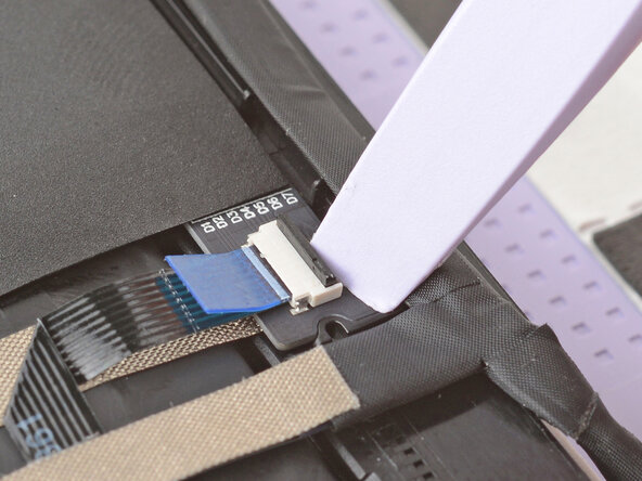

  13. Framework Laptop 12 Display Replacement: 13 단계, 이미지 3개 중 1개 Framework Laptop 12 Display Replacement: 13 단계, 이미지 3개 중 2개 Framework Laptop 12 Display Replacement: 13 단계, 이미지 3개 중 3개
    • Use the flat end of your Framework Screwdriver or a fingernail to gently pry up the locking tab on the webcam cable ZIF connector.

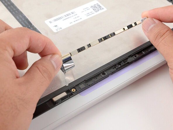

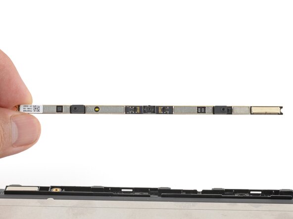

  14. Framework Laptop 12 Display Replacement, Remove the webcam: 14 단계, 이미지 3개 중 1개 Framework Laptop 12 Display Replacement, Remove the webcam: 14 단계, 이미지 3개 중 2개 Framework Laptop 12 Display Replacement, Remove the webcam: 14 단계, 이미지 3개 중 3개
    • Slide the webcam cable out of its connector.
    • Remove the webcam.
    댓글 쓰기

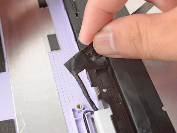

  15. Framework Laptop 12 Display Replacement, Detach the webcam cable: 15 단계, 이미지 3개 중 1개 Framework Laptop 12 Display Replacement, Detach the webcam cable: 15 단계, 이미지 3개 중 2개 Framework Laptop 12 Display Replacement, Detach the webcam cable: 15 단계, 이미지 3개 중 3개
    • The webcam cable is lightly adhered to the display.
    • Grab the webcam cable with your fingers and slowly peel it away from the display.
    • Carefully move the cable off of the display.

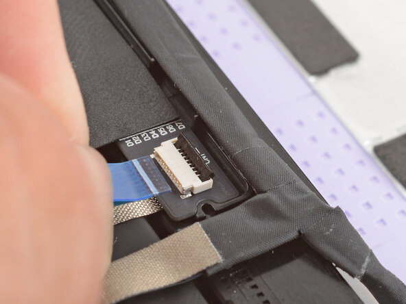

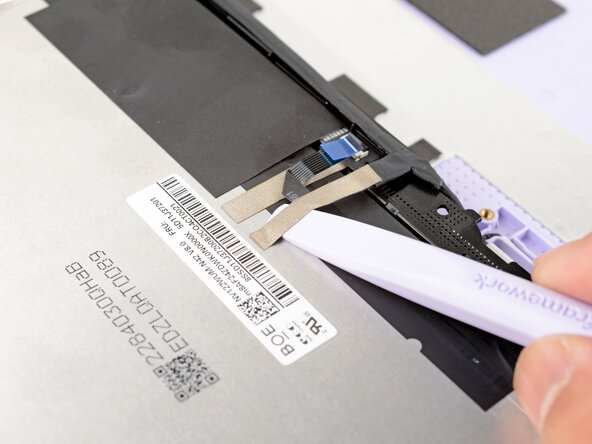

  16. Framework Laptop 12 Display Replacement, Disconnect the touch control cable: 16 단계, 이미지 3개 중 1개 Framework Laptop 12 Display Replacement, Disconnect the touch control cable: 16 단계, 이미지 3개 중 2개 Framework Laptop 12 Display Replacement, Disconnect the touch control cable: 16 단계, 이미지 3개 중 3개
    • Use the flat end of your Framework Screwdriver or a fingernail to gently pry up the locking tab on the touch control ZIF connector near the hinge edge of the display.
    • Use your fingers to grab the touch control cable by the blue tab and slide the cable out of the connector.

  17. Framework Laptop 12 Display Replacement, Separate the silver tape: 17 단계, 이미지 3개 중 1개 Framework Laptop 12 Display Replacement, Separate the silver tape: 17 단계, 이미지 3개 중 2개 Framework Laptop 12 Display Replacement, Separate the silver tape: 17 단계, 이미지 3개 중 3개
    • Slide the flat end of your Framework Screwdriver under the grounding tape securing the display cable.
    • Lift slowly to separate the tape from the display.
    • Keep this tape clean and intact during your repair. You'll use it to attach the cable during reassembly.

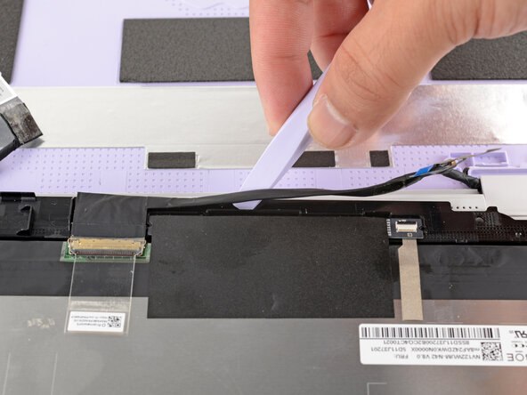

  18. Framework Laptop 12 Display Replacement, Detach the display cable: 18 단계, 이미지 3개 중 1개 Framework Laptop 12 Display Replacement, Detach the display cable: 18 단계, 이미지 3개 중 2개 Framework Laptop 12 Display Replacement, Detach the display cable: 18 단계, 이미지 3개 중 3개
    • The display cable is lightly adhered to the bottom edge of the display.
    • Slide the flat end of your Framework Screwdriver under the length of the display cable to separate it from the display.
    댓글 쓰기

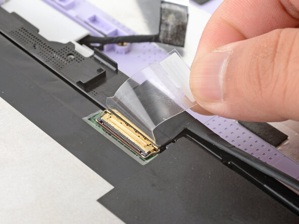

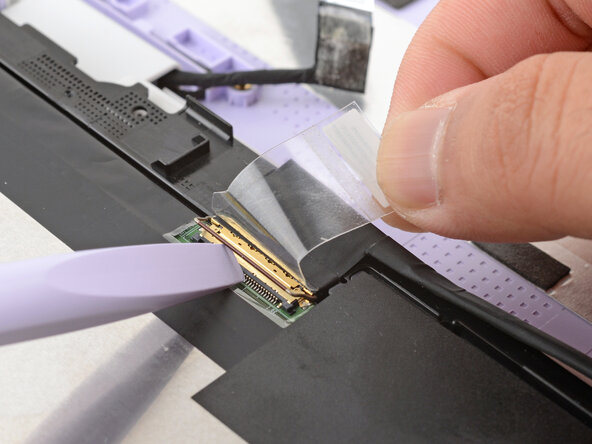

  19. Framework Laptop 12 Display Replacement, Disconnect the display cable: 19 단계, 이미지 2개 중 1개 Framework Laptop 12 Display Replacement, Disconnect the display cable: 19 단계, 이미지 2개 중 2개
    • Use your fingers to peel up the clear tab covering the display cable connector.

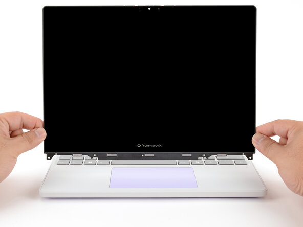

  22. Framework Laptop 12 Display Replacement, Remove the display: 22 단계, 이미지 3개 중 1개 Framework Laptop 12 Display Replacement, Remove the display: 22 단계, 이미지 3개 중 2개 Framework Laptop 12 Display Replacement, Remove the display: 22 단계, 이미지 3개 중 3개
    • Carefully lift and remove the display.
    댓글 쓰기

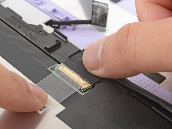

  29. Framework Laptop 12 Display Replacement: 29 단계, 이미지 2개 중 1개 Framework Laptop 12 Display Replacement: 29 단계, 이미지 2개 중 2개
    • Use your finger to press the display cable grounding tape onto the metal back of the display.
    • Use your fingers to press the display cable onto the display.

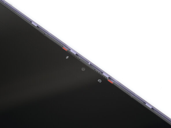

  36. Framework Laptop 12 Display Replacement, Slide the display in place: 36 단계, 이미지 3개 중 1개 Framework Laptop 12 Display Replacement, Slide the display in place: 36 단계, 이미지 3개 중 2개 Framework Laptop 12 Display Replacement, Slide the display in place: 36 단계, 이미지 3개 중 3개
    • Align the display in the Top Cover such that the top edge of the display is slightly below the top edge of the Top Cover.
    • Use your fingers to slide the display upwards to latch the tabs on the top edge of the display.
    • The top edge shouldn't have any gaps when the display's in place.

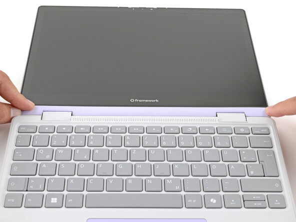

  38. Framework Laptop 12 Display Replacement, Install the Display Cover: 38 단계, 이미지 2개 중 1개 Framework Laptop 12 Display Replacement, Install the Display Cover: 38 단계, 이미지 2개 중 2개
    • Align the Display Cover to the bottom of the display.
    댓글 쓰기
  39. Framework Laptop 12 Display Replacement: 39 단계, 이미지 2개 중 1개 Framework Laptop 12 Display Replacement: 39 단계, 이미지 2개 중 2개
    • Use your finger to press along the length of the Display Cover to snap it onto the laptop.
    • Make sure all the clips along the left, top, and right edges are fully seated.
