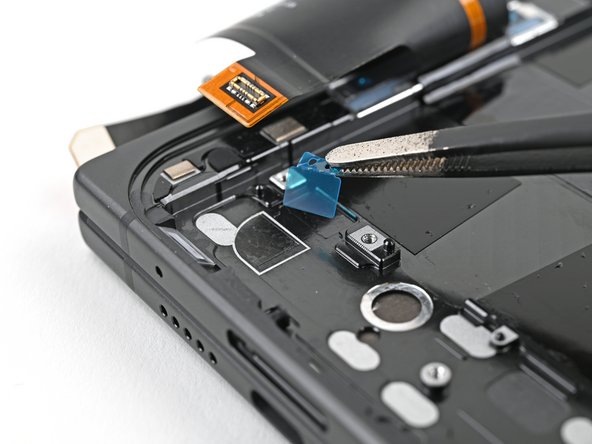

  16. Google Pixel 9 Pro Fold Flip Battery Replacement, Remove the rubber block: 16 단계, 이미지 2개 중 1개 Google Pixel 9 Pro Fold Flip Battery Replacement, Remove the rubber block: 16 단계, 이미지 2개 중 2개
    • Use tweezers, or your fingers, to remove the rubber block covering a screw on the top board.

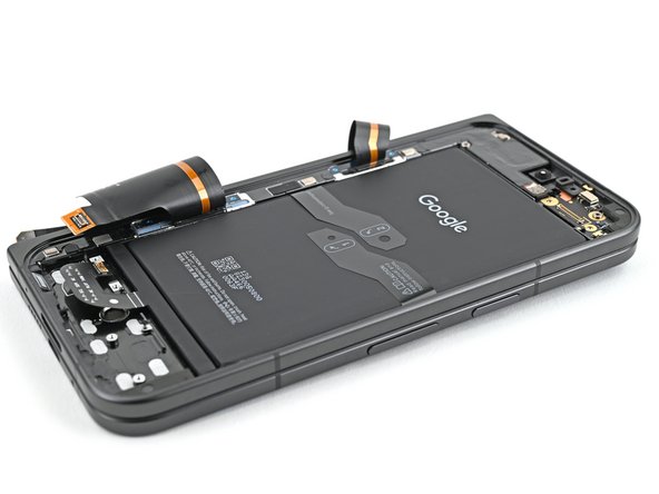

  27. Google Pixel 9 Pro Fold Flip Battery Replacement, Remove the flip battery: 27 단계, 이미지 3개 중 1개 Google Pixel 9 Pro Fold Flip Battery Replacement, Remove the flip battery: 27 단계, 이미지 3개 중 2개 Google Pixel 9 Pro Fold Flip Battery Replacement, Remove the flip battery: 27 단계, 이미지 3개 중 3개
    • Use your fingers to peel both edges of the flip battery pull tabs off the battery.

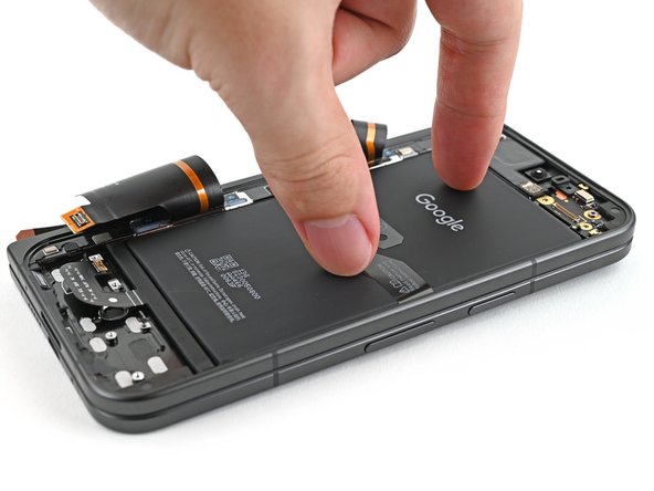

  29. Google Pixel 9 Pro Fold Flip Battery Replacement: 29 단계, 이미지 3개 중 1개 Google Pixel 9 Pro Fold Flip Battery Replacement: 29 단계, 이미지 3개 중 2개 Google Pixel 9 Pro Fold Flip Battery Replacement: 29 단계, 이미지 3개 중 3개
    • Fold your phone and turn it so the flip battery is facing up.
    • Pull up on alternating sides of the pull tab to slice through the adhesive on the upper half of the flip battery, stopping once you get to the top edge.
    • Try to not lose one of the sides of the pull tab under the battery. If you do, don't worry! Move to the next step for an alternate method to remove the battery.

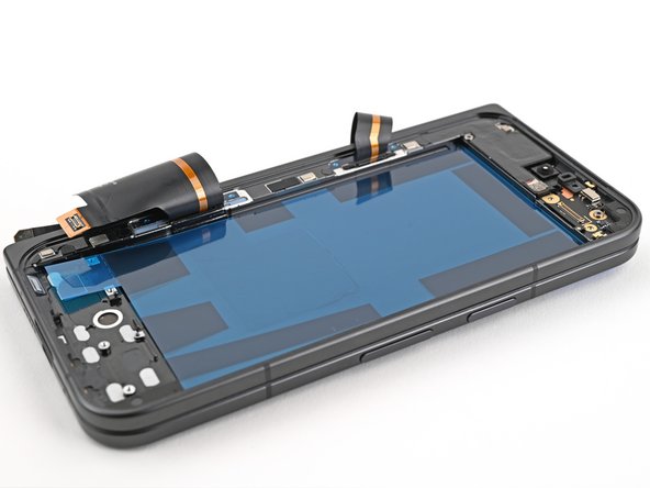

  33. Google Pixel 9 Pro Fold Flip Battery Replacement, End of disassembly: 33 단계, 이미지 1개 중 1개
    • Congratulations on completing disassembly! The remaining steps will show you how to reassemble your device.
  34. Google Pixel 9 Pro Fold Flip Battery Replacement, Remove the old adhesive: 34 단계, 이미지 3개 중 1개 Google Pixel 9 Pro Fold Flip Battery Replacement, Remove the old adhesive: 34 단계, 이미지 3개 중 2개 Google Pixel 9 Pro Fold Flip Battery Replacement, Remove the old adhesive: 34 단계, 이미지 3개 중 3개
    • Use tweezers, or your fingers, to remove the old flip battery adhesive from the frame.

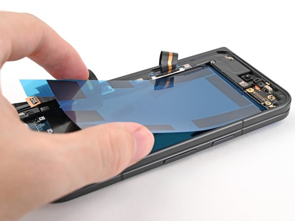

  35. Google Pixel 9 Pro Fold Flip Battery Replacement: 35 단계, 이미지 3개 중 1개 Google Pixel 9 Pro Fold Flip Battery Replacement: 35 단계, 이미지 3개 중 2개 Google Pixel 9 Pro Fold Flip Battery Replacement: 35 단계, 이미지 3개 중 3개
    • Apply isopropyl alcohol (>90%) and use a coffee filter or microfiber cloth to clean any adhesive residue.
  36. Google Pixel 9 Pro Fold Flip Battery Replacement, Apply the new adhesive: 36 단계, 이미지 3개 중 1개 Google Pixel 9 Pro Fold Flip Battery Replacement, Apply the new adhesive: 36 단계, 이미지 3개 중 2개 Google Pixel 9 Pro Fold Flip Battery Replacement, Apply the new adhesive: 36 단계, 이미지 3개 중 3개
    • The adhesives for the flip battery cable and connector are separate from the main adhesive strip.
    • Place the flip battery cable and connector adhesives over the frame, using the white outlines to confirm their orientation.
    • The clear liners should face the frame.
    • Peel the adhesive strips off their liners and place them over their respective spots on the frame.

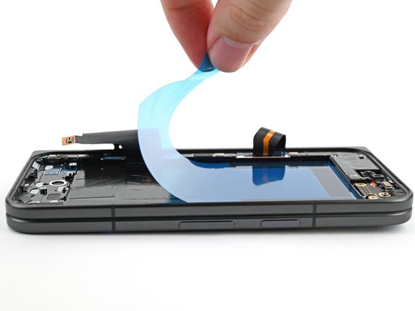

  38. Google Pixel 9 Pro Fold Flip Battery Replacement: 38 단계, 이미지 3개 중 1개 Google Pixel 9 Pro Fold Flip Battery Replacement: 38 단계, 이미지 3개 중 2개 Google Pixel 9 Pro Fold Flip Battery Replacement: 38 단계, 이미지 3개 중 3개
    • Peel the main flip battery adhesive strip from its clear liner.
    • Align the top edge of the adhesive strip with the top edge of the battery recess.
    • The pull tab should be in the bottom left corner of the frame.
    • Lay the adhesive strip on the frame.

  48. Google Pixel 9 Pro Fold Flip Battery Replacement: 48 단계, 이미지 2개 중 1개 Google Pixel 9 Pro Fold Flip Battery Replacement: 48 단계, 이미지 2개 중 2개
    • Use a Torx Plus 3IP driver to install the two 2.2 mm‑long screws securing the bottom interconnect cable bracket.
  49. Google Pixel 9 Pro Fold Flip Battery Replacement, Reconnect the top interconnect cable: 49 단계, 이미지 1개 중 1개
    • Reconnect the top interconnect cable press connector.
  50. Google Pixel 9 Pro Fold Flip Battery Replacement, Reinstall the top interconnect cable bracket: 50 단계, 이미지 2개 중 1개 Google Pixel 9 Pro Fold Flip Battery Replacement, Reinstall the top interconnect cable bracket: 50 단계, 이미지 2개 중 2개
    • Place the top interconnect cable bracket on the top board and align its screw holes.
  51. Google Pixel 9 Pro Fold Flip Battery Replacement: 51 단계, 이미지 2개 중 1개 Google Pixel 9 Pro Fold Flip Battery Replacement: 51 단계, 이미지 2개 중 2개
    • Use a Torx Plus 3IP driver to install the two 2.2 mm‑long screws securing the top interconnect cable bracket.
  52. Google Pixel 9 Pro Fold Flip Battery Replacement, Reinstall the rubber block: 52 단계, 이미지 2개 중 1개 Google Pixel 9 Pro Fold Flip Battery Replacement, Reinstall the rubber block: 52 단계, 이미지 2개 중 2개
    • Place the rubber block over its spot on the top board and press it down.
  53. Google Pixel 9 Pro Fold Flip Battery Replacement, Reconnect the flip battery: 53 단계, 이미지 1개 중 1개
    • Reconnect the flip battery press connector.
  54. Google Pixel 9 Pro Fold Flip Battery Replacement, Reinstall the flip battery bracket: 54 단계, 이미지 2개 중 1개 Google Pixel 9 Pro Fold Flip Battery Replacement, Reinstall the flip battery bracket: 54 단계, 이미지 2개 중 2개
    • Lay the flip battery bracket over the press connector and align the screw holes.
  55. Google Pixel 9 Pro Fold Flip Battery Replacement: 55 단계, 이미지 2개 중 1개 Google Pixel 9 Pro Fold Flip Battery Replacement: 55 단계, 이미지 2개 중 2개
    • Use a Torx Plus 3IP driver to install the 2.0 mm‑long screw securing the battery bracket.
  56. Google Pixel 9 Pro Fold Flip Battery Replacement, Remove the old adhesive: 56 단계, 이미지 2개 중 1개 Google Pixel 9 Pro Fold Flip Battery Replacement, Remove the old adhesive: 56 단계, 이미지 2개 중 2개
    • If your outer screen adhesive at the bottom left corner isn't sticky anymore, follow the next four steps to replace it. Otherwise, skip the next four steps.
    • Use a spudger, or your fingers, to remove the old bottom left outer screen adhesive.
    • Use isopropyl alcohol (>90%) and a coffee filter or a microfiber cloth to remove any adhesive residue.
  57. Google Pixel 9 Pro Fold Flip Battery Replacement, Compare your new adhesive: 57 단계, 이미지 2개 중 1개 Google Pixel 9 Pro Fold Flip Battery Replacement, Compare your new adhesive: 57 단계, 이미지 2개 중 2개
    • Before removing any liners, check if the bottom left outer screen adhesive matches the frame.
    • The clear liner should face the frame.
  58. Google Pixel 9 Pro Fold Flip Battery Replacement, Apply the new adhesive: 58 단계, 이미지 3개 중 1개 Google Pixel 9 Pro Fold Flip Battery Replacement, Apply the new adhesive: 58 단계, 이미지 3개 중 2개 Google Pixel 9 Pro Fold Flip Battery Replacement, Apply the new adhesive: 58 단계, 이미지 3개 중 3개
    • Peel the bottom left outer screen adhesive off its clear liner to expose the adhesive.
    • Put the adhesive into place on the frame.
  59. Google Pixel 9 Pro Fold Flip Battery Replacement: 59 단계, 이미지 2개 중 1개 Google Pixel 9 Pro Fold Flip Battery Replacement: 59 단계, 이미지 2개 중 2개
    • Use the flat end of a spudger to press along the adhesive strip to adhere it to the frame.
  60. Google Pixel 9 Pro Fold Flip Battery Replacement, Apply the new adhesive: 60 단계, 이미지 2개 중 1개 Google Pixel 9 Pro Fold Flip Battery Replacement, Apply the new adhesive: 60 단계, 이미지 2개 중 2개
    • Before removing any liners, check if the perimeter outer screen adhesive matches the frame.

  66. Google Pixel 9 Pro Fold Flip Battery Replacement: 66 단계, 이미지 2개 중 1개 Google Pixel 9 Pro Fold Flip Battery Replacement: 66 단계, 이미지 2개 중 2개
    • Use the tip of a spudger to pry up the segmented tab on the bottom left corner of the large blue liner.
  67. Google Pixel 9 Pro Fold Flip Battery Replacement: 67 단계, 이미지 3개 중 1개 Google Pixel 9 Pro Fold Flip Battery Replacement: 67 단계, 이미지 3개 중 2개 Google Pixel 9 Pro Fold Flip Battery Replacement: 67 단계, 이미지 3개 중 3개
    • Lift the tab and peel off the large blue liner to expose the secondary liner.
    • If any of the adhesive starts to peel up with the liner, gently lay it back on the frame and use the flat end of a spudger to secure it to the frame.
  68. Google Pixel 9 Pro Fold Flip Battery Replacement, Reconnect the outer screen: 68 단계, 이미지 2개 중 1개 Google Pixel 9 Pro Fold Flip Battery Replacement, Reconnect the outer screen: 68 단계, 이미지 2개 중 2개
    • Support the screen with your hand or prop it up on something sturdy.
    • Reconnect the outer screen cable press connector.
  69. Google Pixel 9 Pro Fold Flip Battery Replacement, Reinstall the outer screen cable bracket: 69 단계, 이미지 2개 중 1개 Google Pixel 9 Pro Fold Flip Battery Replacement, Reinstall the outer screen cable bracket: 69 단계, 이미지 2개 중 2개
    • Reinsert the outer screen cable bracket clip under the frame and align its screw hole.
  70. Google Pixel 9 Pro Fold Flip Battery Replacement: 70 단계, 이미지 2개 중 1개 Google Pixel 9 Pro Fold Flip Battery Replacement: 70 단계, 이미지 2개 중 2개
    • Use a Torx Plus 3IP driver to install the 2.2 mm‑long screw securing the display cable bracket.
  71. Google Pixel 9 Pro Fold Flip Battery Replacement, Expose the adhesive: 71 단계, 이미지 3개 중 1개 Google Pixel 9 Pro Fold Flip Battery Replacement, Expose the adhesive: 71 단계, 이미지 3개 중 2개 Google Pixel 9 Pro Fold Flip Battery Replacement, Expose the adhesive: 71 단계, 이미지 3개 중 3개
    • Remove the blue liner from the bottom left outer screen adhesive strip.
    • While holding the screen above the frame, separate one of the secondary liner's pull tabs at the bottom left corner.
  72. Google Pixel 9 Pro Fold Flip Battery Replacement: 72 단계, 이미지 3개 중 1개 Google Pixel 9 Pro Fold Flip Battery Replacement: 72 단계, 이미지 3개 중 2개 Google Pixel 9 Pro Fold Flip Battery Replacement: 72 단계, 이미지 3개 중 3개
    • Still holding the screen, peel off the secondary liner to expose the adhesive.
  73. Google Pixel 9 Pro Fold Flip Battery Replacement, Secure the outer screen: 73 단계, 이미지 2개 중 1개 Google Pixel 9 Pro Fold Flip Battery Replacement, Secure the outer screen: 73 단계, 이미지 2개 중 2개
    • Align the outer screen over the frame and press it into place.
  74. Google Pixel 9 Pro Fold Flip Battery Replacement: 74 단계, 이미지 2개 중 1개 Google Pixel 9 Pro Fold Flip Battery Replacement: 74 단계, 이미지 2개 중 2개
    • Press along the perimeter of the outer screen to adhere it to the frame.
    • Optionally, you can use a hair dryer or heat gun to lightly heat the edges of the back cover and create a stronger bond.
    • Let the phone sit a few hours for the adhesive to cure.
