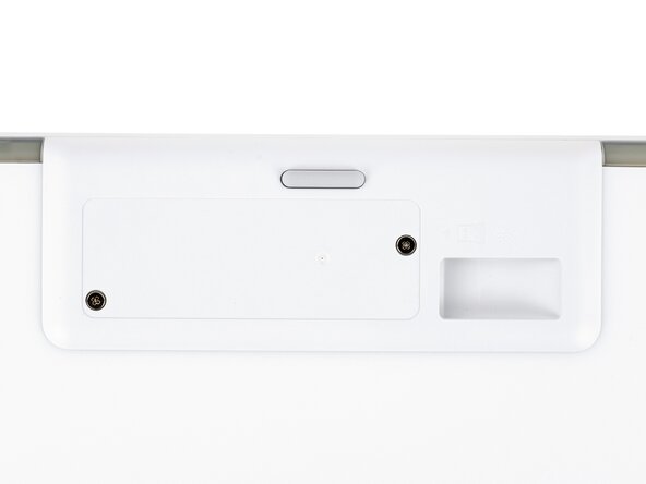

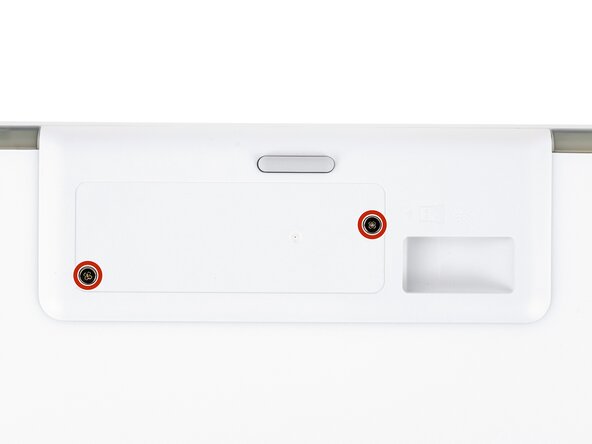

  5. Logitech G715 Battery Replacement, Remove the battery cover screws: 5 단계, 이미지 2개 중 1개 Logitech G715 Battery Replacement, Remove the battery cover screws: 5 단계, 이미지 2개 중 2개
    • Use a Phillips screwdriver to remove the two 8.4 mm‑long screws securing the battery cover.

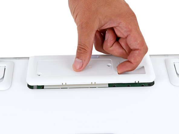

  6. Logitech G715 Battery Replacement, Reposition the battery cover: 6 단계, 이미지 3개 중 1개 Logitech G715 Battery Replacement, Reposition the battery cover: 6 단계, 이미지 3개 중 2개 Logitech G715 Battery Replacement, Reposition the battery cover: 6 단계, 이미지 3개 중 3개
    • Plastic clips secure the edges of the battery cover.
    • Insert your finger in the USB receiver compartment on the battery cover.
    • Pull up the bottom edge of the cover to release the clips.
    • Don't try to fully remove the cover yet, as it's still connected by the battery cable.
    • Gently pull the cover to the right so you can access the battery connector on the left side of the recess.

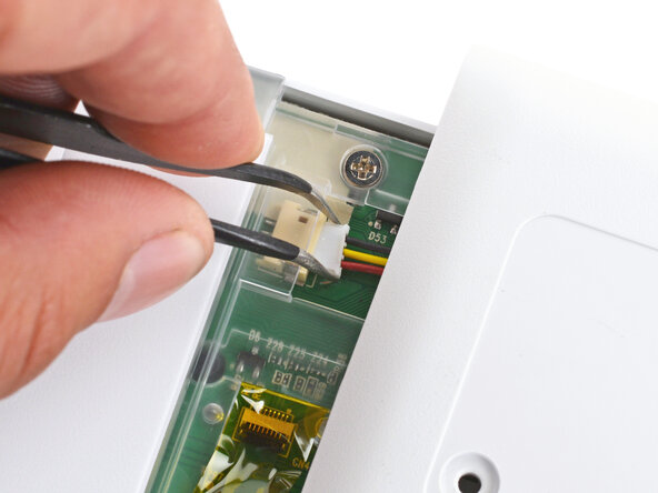

  7. Logitech G715 Battery Replacement, Disconnect the battery: 7 단계, 이미지 3개 중 1개 Logitech G715 Battery Replacement, Disconnect the battery: 7 단계, 이미지 3개 중 2개 Logitech G715 Battery Replacement, Disconnect the battery: 7 단계, 이미지 3개 중 3개
    • Use a pair of angled tweezers to firmly grip the battery connector.
    • Hold the tweezers with your fingers as close to the connector as possible to get a firm grip.
    • Gently rock the connector side‑to‑side and slide it straight out of the socket.

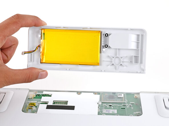

  8. Logitech G715 Battery Replacement, Remove the battery cover: 8 단계, 이미지 1개 중 1개
    • Remove the battery cover.

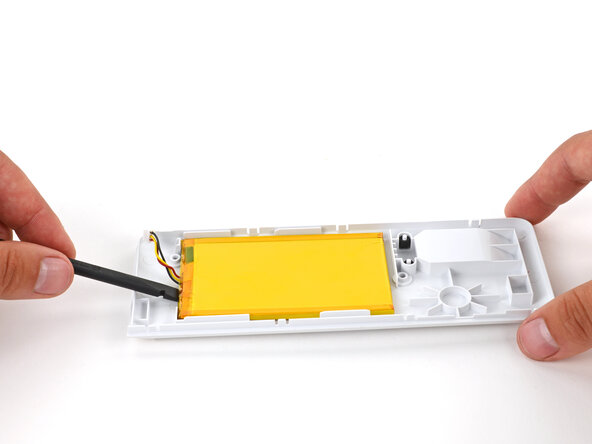

  9. Logitech G715 Battery Replacement, Remove the battery: 9 단계, 이미지 3개 중 1개 Logitech G715 Battery Replacement, Remove the battery: 9 단계, 이미지 3개 중 2개 Logitech G715 Battery Replacement, Remove the battery: 9 단계, 이미지 3개 중 3개
    이 단계에 사용된 도구:
    Tesa 61395 Tape
    $2.99
    • Light adhesive secures the battery to its cover.
    • Gently slide the flat end of a spudger under one of the short edges of the battery and lift to separate the adhesive.
    • Be very careful not to puncture the battery, as it can leak dangerous chemicals or catch fire.
    • Remove the battery from its cover.
    • During reassembly:
    • Remove any old adhesive from the battery cover.
    • Use thin, double‑sided tape to secure the battery to the cover.
    • Make sure the battery is properly positioned on the cover. The cable should be on the side opposite the USB receiver, and the battery should be within the guide rails.
