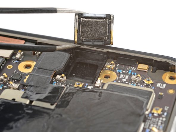

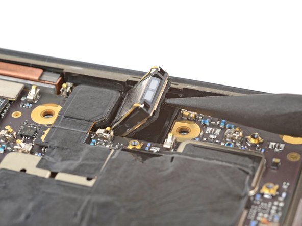

  20. Motorola Edge 5G UW (2022) Earpiece Speaker Replacement, Remove the earpiece speaker: 20 단계, 이미지 3개 중 1개 Motorola Edge 5G UW (2022) Earpiece Speaker Replacement, Remove the earpiece speaker: 20 단계, 이미지 3개 중 2개 Motorola Edge 5G UW (2022) Earpiece Speaker Replacement, Remove the earpiece speaker: 20 단계, 이미지 3개 중 3개
    이 단계에 사용된 도구:
    • Note the orientation of the earpiece speaker. During reassembly it must be reinserted the same way or the speaker won't work.
    • Insert the pointed end of a spudger between the earpiece speaker and its housing
    • Pry up with the spudger to dislodge the speaker.
    • A small amount of adhesive secures the speaker.
    • Use your fingers or tweezers to remove the speaker.
    • Before reinserting the speaker, ensure that the speaker's mesh is in its recess and that the raised ends of the speaker's contacts are on the right.
