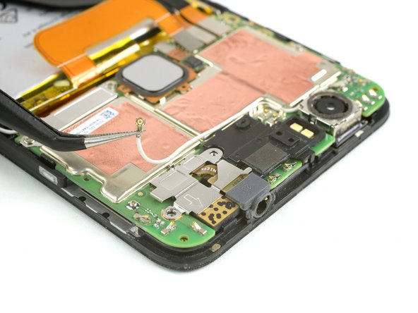

    • Unscrew the two Philipps #000 screws.
    • Use tweezers to disconnect the antenna cable.
    • Remove the metal plate covering the front facing camera and the headphone jack.

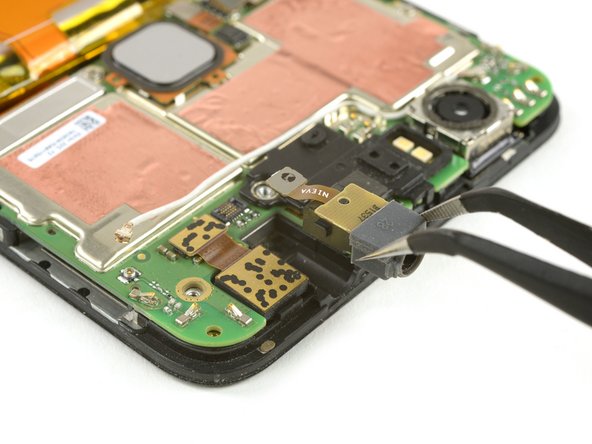

    • Use the flat end of a spudger to disconnect the headphone jack flex cable.
    • Remove the headphone jack.
