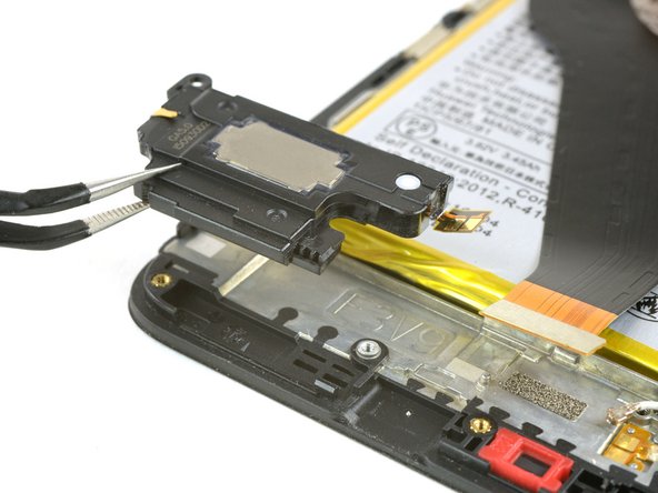

  10. Nexus 6P Loudspeaker Replacement, Loudspeaker: 10 단계, 이미지 3개 중 1개 Nexus 6P Loudspeaker Replacement, Loudspeaker: 10 단계, 이미지 3개 중 2개 Nexus 6P Loudspeaker Replacement, Loudspeaker: 10 단계, 이미지 3개 중 3개
    이 단계에 사용된 도구:
    • Unscrew the Philipps #000 screw.
    • There is some adhesive beneath the loudspeaker, especially under the small flex cable on its side. Don't damage or rip the cable while you remove it.
    • Use the flat end of a spudger to pry off the loudspeaker.
    • Use tweezers to grab the loudspeaker and remove it.
