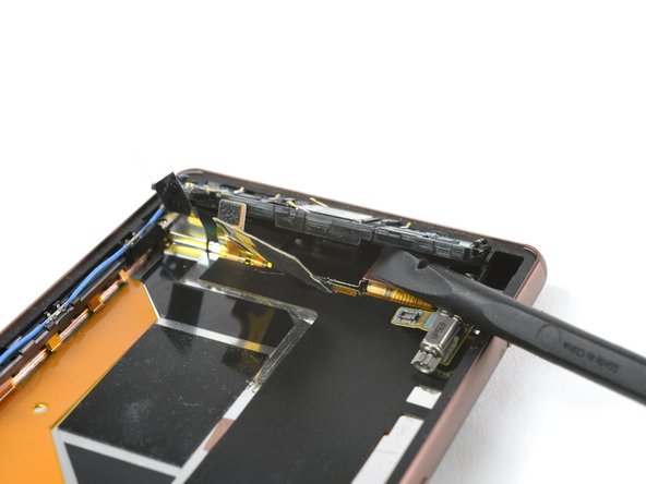

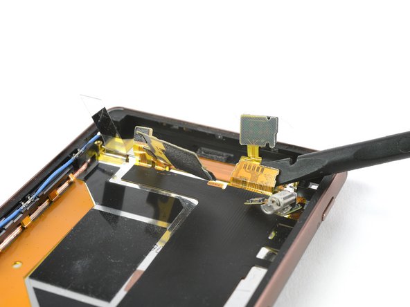

  9. Sony Xperia Z3 LCD & Digitizer Replacement: 9 단계, 이미지 3개 중 1개 Sony Xperia Z3 LCD & Digitizer Replacement: 9 단계, 이미지 3개 중 2개 Sony Xperia Z3 LCD & Digitizer Replacement: 9 단계, 이미지 3개 중 3개
    • Remove the cover on top of the loudspeaker assembly.
    • Use a spudger to pull out the vibration motor and remove its rubber gasket with a tweezer.

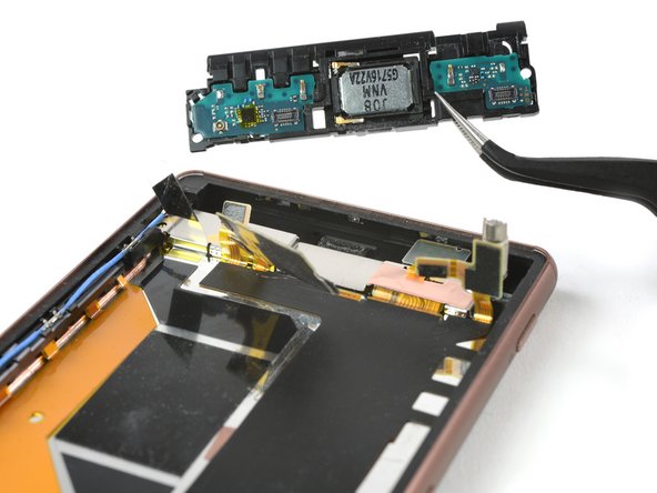

  10. Sony Xperia Z3 LCD & Digitizer Replacement: 10 단계, 이미지 3개 중 1개 Sony Xperia Z3 LCD & Digitizer Replacement: 10 단계, 이미지 3개 중 2개 Sony Xperia Z3 LCD & Digitizer Replacement: 10 단계, 이미지 3개 중 3개

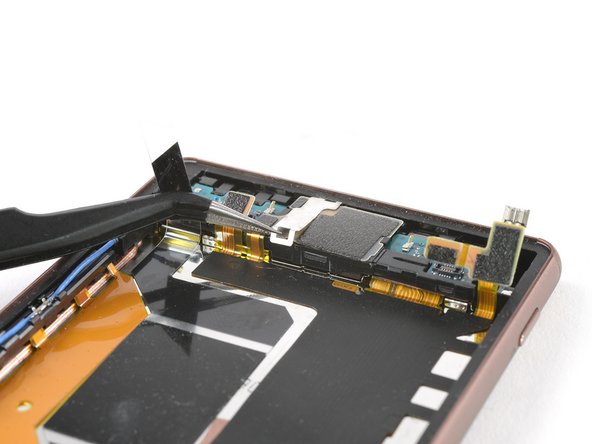

    • Use a tweezer to remove the adhesive strip of the loudspeaker assembly.
    • Pull up the metal clamp at the upper end of the loudspeaker assembly by using a tweezer and remove it.

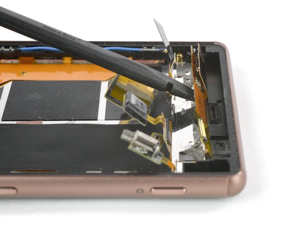

  11. Sony Xperia Z3 LCD & Digitizer Replacement: 11 단계, 이미지 3개 중 1개 Sony Xperia Z3 LCD & Digitizer Replacement: 11 단계, 이미지 3개 중 2개 Sony Xperia Z3 LCD & Digitizer Replacement: 11 단계, 이미지 3개 중 3개
    • Lift up the main flex cable covering the loudspeaker assembly with a Spudger
    • Take care to not damage the loudspeaker. The flex cable is attached to the assembly with adhesive and is a little bit sticky.
    • Lift up the whole loudspeaker assembly with a spudger and remove it.

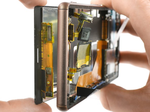

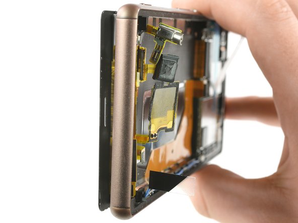

  17. Sony Xperia Z3 LCD & Digitizer Replacement: 17 단계, 이미지 3개 중 1개 Sony Xperia Z3 LCD & Digitizer Replacement: 17 단계, 이미지 3개 중 2개 Sony Xperia Z3 LCD & Digitizer Replacement: 17 단계, 이미지 3개 중 3개
    • To fully remove the display off your phone, you need to thread the display flex cable through the gap of the mid frame in the bottom end of your phone.
    • Take care of all the connectors of the main flex cable hanging around and of course the display flex cable itself.
