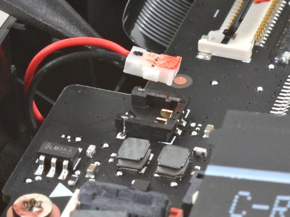

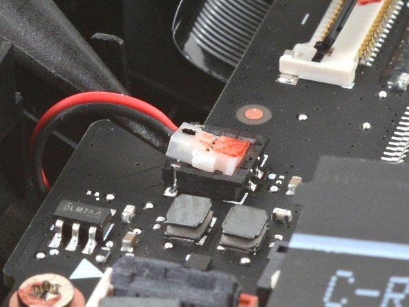

  • If you aren't replacing your button board, you can leave this cable connected and lay the board over the left side of the frame after you've removed the screws.
  • Be careful when disconnecting the haptics, as the cables and connector are very delicate. Pry only on the base of the white connector, and not on the cables or socket.
  • Insert the point of your spudger under the neck of the haptics cable connector.
  • Gently pry up to disconnect it.
