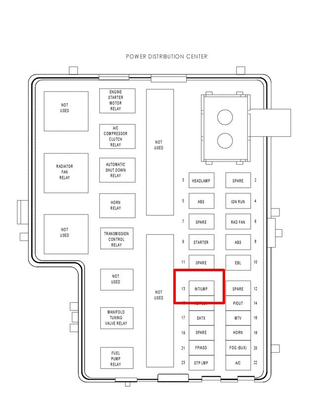

Miles odometer keep showing fuse
It keep showing fuse

Erol, here is a solution from the manual:"In the event that the instrument cluster looses communication with all other modules on the PCI bus, the cluster will display “nobus” in the VF display. The VF display also displays “Door”, “Cruise”, “Trac”, and odometer trip or total.
If the cluster does not detect voltage on the courtesy lamp circuit, the message “FUSE” will alternate with the odometer/trip odometer for 30 seconds after the ignition is turned on and for 15 seconds after the vehicle is first moved. The lack of voltage can be due to the M1 Fused B(+) (IOD) fuse being open, a bad or missing courtesy lamp bulb, or a circuit problem." First thing to check is the dome light:-) then the IOD (ignition off draw) fuse which is #13 located under the hood in the power distribution center. Hope this helps, good luck.
