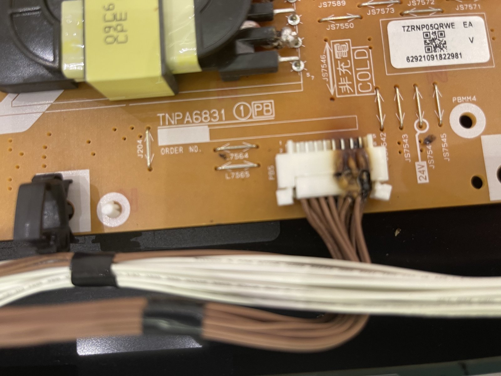

Fixed by attaching the wires directly to the PCB
I had this same problem after 5 years. It was impossible to source a replacement PCB and wire as all the Panasonic spare parts places are out of the TNPA6831 board.
이미지
The PCB itself was fine, but the header and wire connection were melted. I was able to get it fixed by having a mobile phone repair store directly attach the wires to the PCB. It's 2mm spacing between the wires, so it was beyond my soldering abilities.
