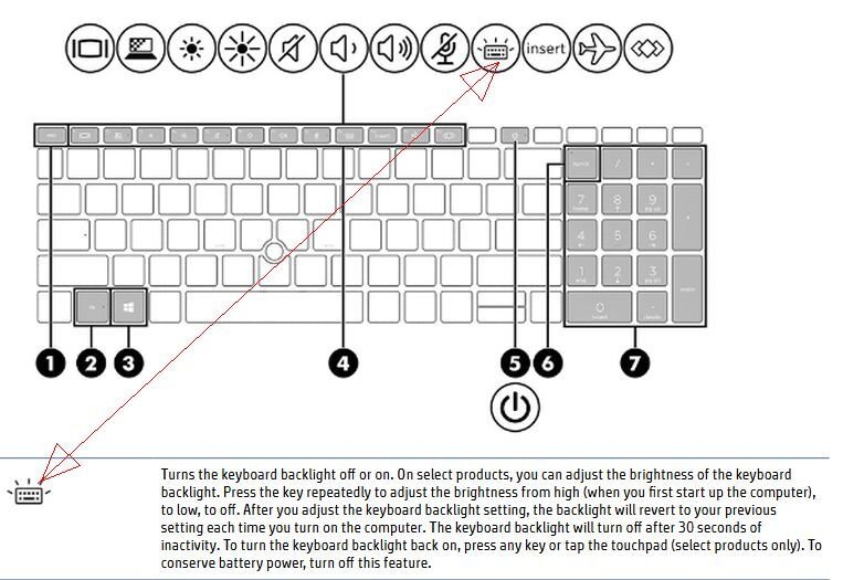

my keyboard backlight is always off, how do i permanently activate it

Hi @ranganaijekese
Here's an image from the user manual for the laptop that shows how to control the keyboard backlights.
(click on image)

Go to BIOS
Advanced
Bult in
Disactivate the automaticly backlight option
