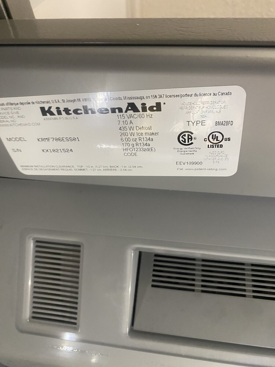

Fridgidaire replacement part identify
Update: I added more pics of broken plastic attachment on each far end of the frig.

Anyone know what the part name or number is for this Frigidaire refrig piece in the picture? It holds up and separates the glass shelf from the meat and produce drawers. It broke some time ago and I noticed the glass sagging with the food weight and thought I better try to replace it. The model is krmf706ess01 thanks

Hi @jeffporter54614
Looking at the parts list for the refrigerator, there doesn't seem to be a part number for the support bracket that holds the crisper cover glass shelf.
Go to Refrigerator Liner parts diagram → Expand the parts diagram and note the bracket on the inside left wall of the compartment which I assume is there to support the shelf. Presumably there's also one on the right side (not shown)
The part number for the crisper cover shelf (part ID #31 Shelf Parts diagram) is W11038526
A sturdy, tempered glass shelf for your refrigerator, enhancing both utility and appearance. 이미지
