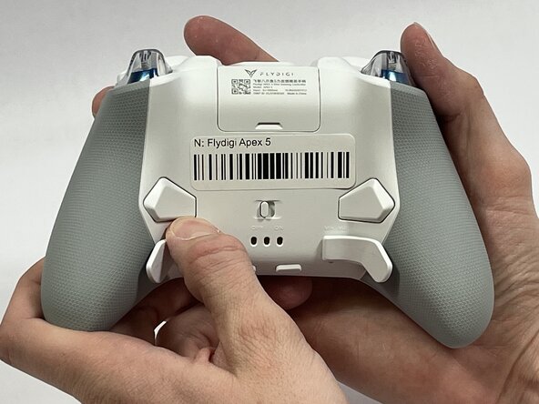

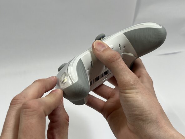

    • Orient the controller so that its back is facing you.
    • Apply firm downward pressure to remove both the M3 and M4 back paddles.
