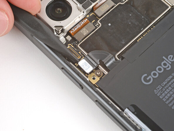

  14. Google Pixel 10 Battery Replacement, Disconnect the back glass: 14 단계, 이미지 2개 중 1개 Google Pixel 10 Battery Replacement, Disconnect the back glass: 14 단계, 이미지 2개 중 2개
    • Use the point of a spudger to pry up and disconnect the back glass press connector.

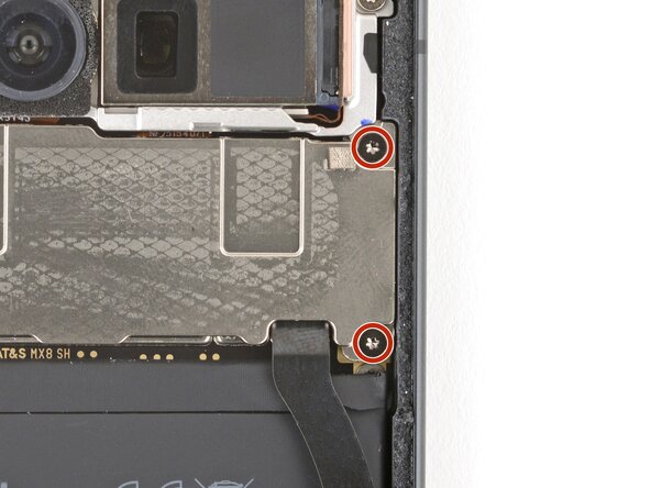

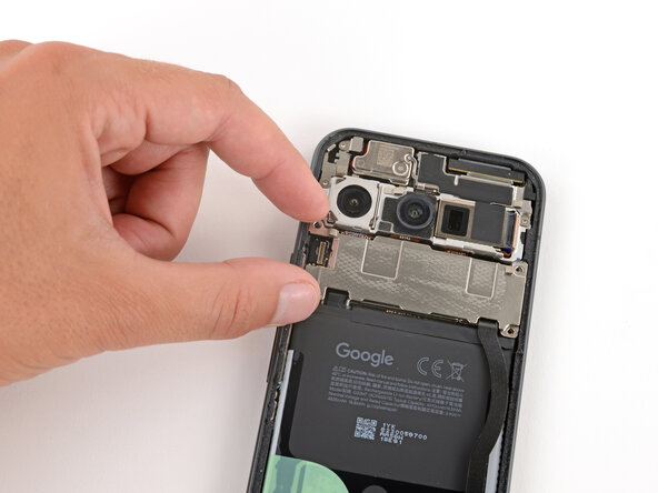

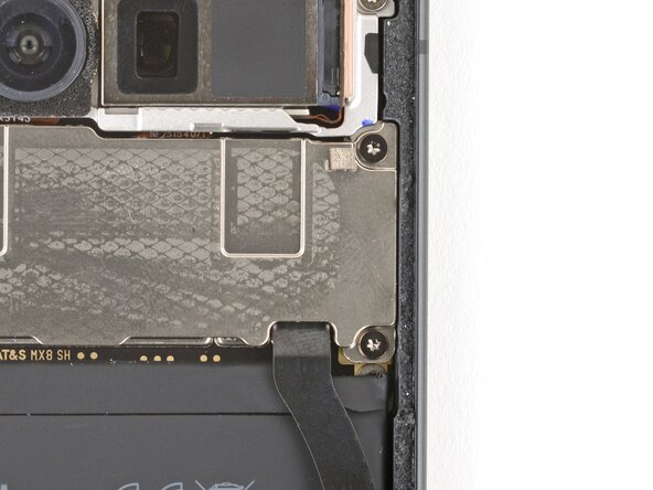

  16. Google Pixel 10 Battery Replacement, Remove the motherboard cover screws: 16 단계, 이미지 2개 중 1개 Google Pixel 10 Battery Replacement, Remove the motherboard cover screws: 16 단계, 이미지 2개 중 2개
    • Use a Torx Plus 3IP screwdriver to remove the two 5.0 mm‑long screws securing the motherboard cover.

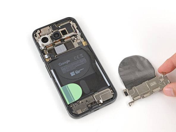

  17. Google Pixel 10 Battery Replacement, Remove the motherboard cover: 17 단계, 이미지 3개 중 1개 Google Pixel 10 Battery Replacement, Remove the motherboard cover: 17 단계, 이미지 3개 중 2개 Google Pixel 10 Battery Replacement, Remove the motherboard cover: 17 단계, 이미지 3개 중 3개
    • Use a spudger to lift the motherboard cover, then grip the cover and slowly peel the graphite sheet off the battery.

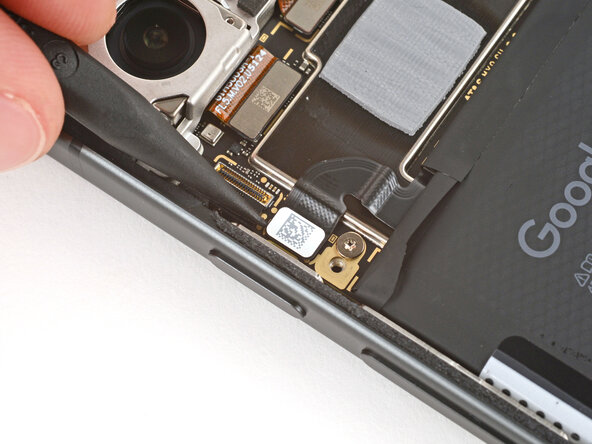

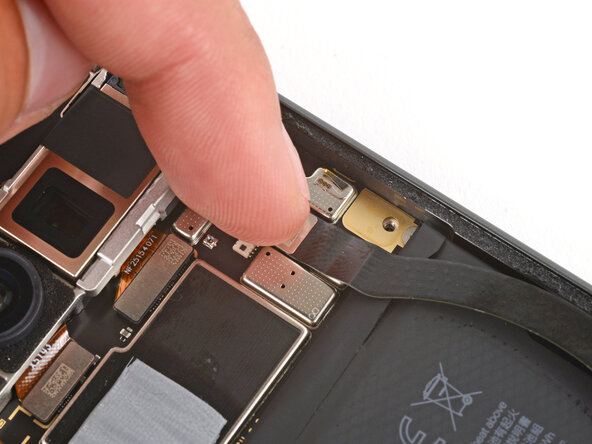

  18. Google Pixel 10 Battery Replacement, Disconnect the battery: 18 단계, 이미지 2개 중 1개 Google Pixel 10 Battery Replacement, Disconnect the battery: 18 단계, 이미지 2개 중 2개
    • Use the point of a spudger to pry up and disconnect the battery press connector.

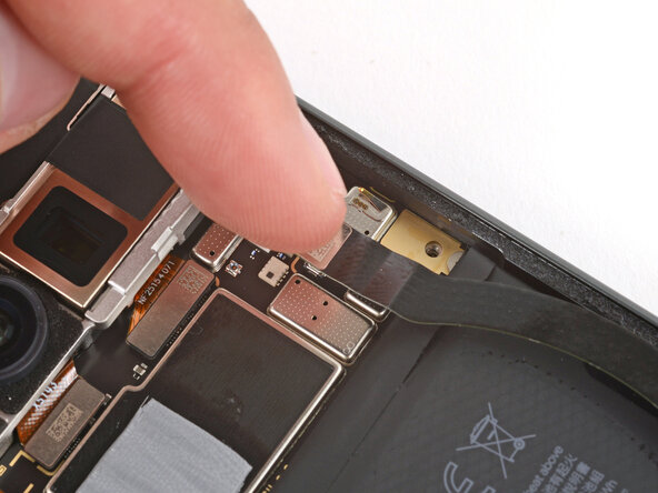

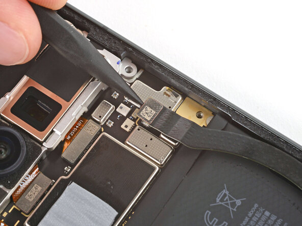

  19. Google Pixel 10 Battery Replacement, Disconnect the interconnect cable: 19 단계, 이미지 2개 중 1개 Google Pixel 10 Battery Replacement, Disconnect the interconnect cable: 19 단계, 이미지 2개 중 2개
    • Use the point of a spudger to pry up and disconnect the interconnect cable press connector from the bottom right of the motherboard.

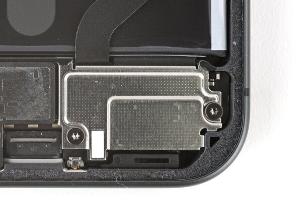

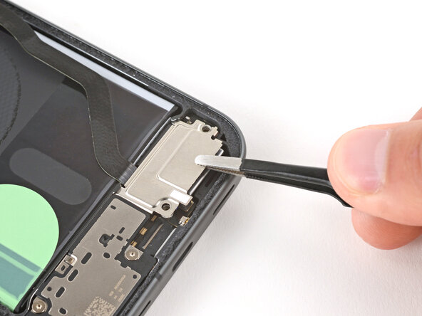

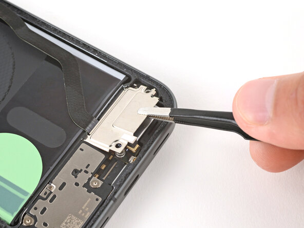

  20. Google Pixel 10 Battery Replacement, Remove the USB‑C board cover: 20 단계, 이미지 2개 중 1개 Google Pixel 10 Battery Replacement, Remove the USB‑C board cover: 20 단계, 이미지 2개 중 2개
    • Use a Torx Plus 3IP screwdriver to remove the two 5.0 mm‑long screws securing the USB‑C board cover.
  21. Google Pixel 10 Battery Replacement: 21 단계, 이미지 3개 중 1개 Google Pixel 10 Battery Replacement: 21 단계, 이미지 3개 중 2개 Google Pixel 10 Battery Replacement: 21 단계, 이미지 3개 중 3개
    • Remove the USB‑C board cover.

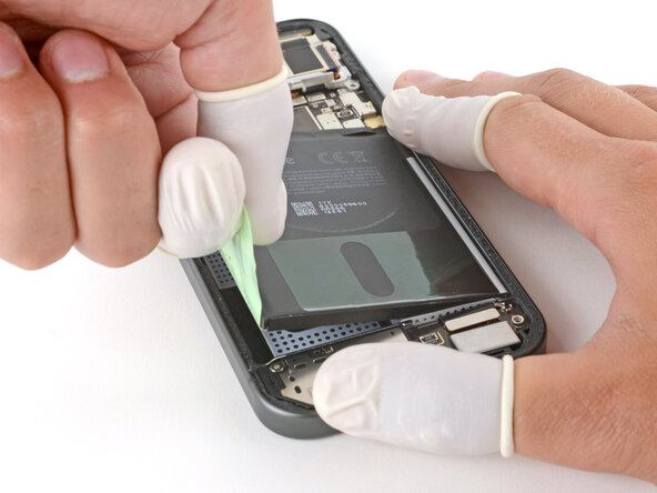

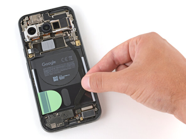

  24. Google Pixel 10 Battery Replacement, Peel up the battery pull tab: 24 단계, 이미지 3개 중 1개 Google Pixel 10 Battery Replacement, Peel up the battery pull tab: 24 단계, 이미지 3개 중 2개 Google Pixel 10 Battery Replacement, Peel up the battery pull tab: 24 단계, 이미지 3개 중 3개
    • Use your fingers to peel up the entire battery tab on the left side of the battery, including the skinny strip running along the side.
  25. Google Pixel 10 Battery Replacement, Use finger stalls: 25 단계, 이미지 1개 중 1개
    이 단계에 사용된 도구:
    Finger Stalls
    $8.99
  26. Google Pixel 10 Battery Replacement, Separate the battery adhesive: 26 단계, 이미지 3개 중 1개 Google Pixel 10 Battery Replacement, Separate the battery adhesive: 26 단계, 이미지 3개 중 2개 Google Pixel 10 Battery Replacement, Separate the battery adhesive: 26 단계, 이미지 3개 중 3개
    • Secure the right side of your phone with one hand, and use your free hand to grip the battery pull tab.
    • Make sure your hand securing the phone is mainly pressing on the frame—it shouldn't be covering the battery or pressing down on delicate components.
    • Pull straight up on the tab and apply constant, steady force until the adhesive separates.

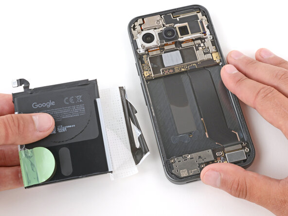

  27. Google Pixel 10 Battery Replacement, Remove the battery: 27 단계, 이미지 3개 중 1개 Google Pixel 10 Battery Replacement, Remove the battery: 27 단계, 이미지 3개 중 2개 Google Pixel 10 Battery Replacement, Remove the battery: 27 단계, 이미지 3개 중 3개
    • Grip the battery and slowly pull it away from your phone to peel the plastic sleeve out of the recess.
    • Remove the battery.

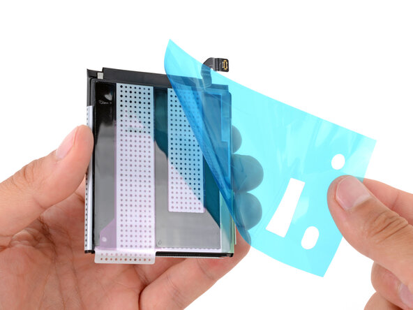

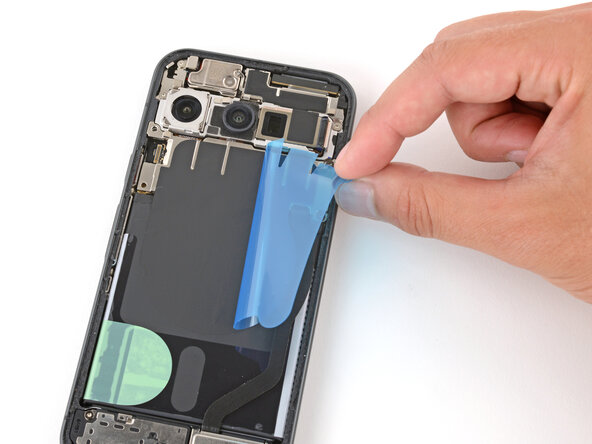

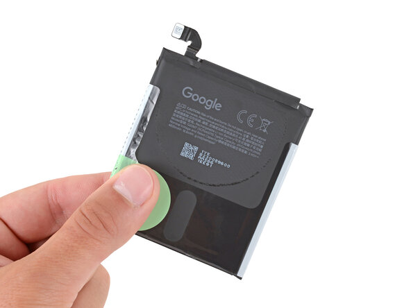

  30. Google Pixel 10 Battery Replacement, Remove the battery liner: 30 단계, 이미지 1개 중 1개
    • Remove the large, colored liner from the battery to expose the adhesive.

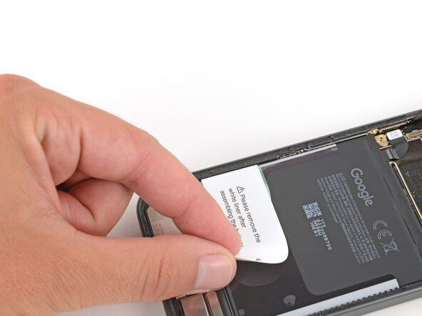

  31. Google Pixel 10 Battery Replacement, Install the battery: 31 단계, 이미지 3개 중 1개 Google Pixel 10 Battery Replacement, Install the battery: 31 단계, 이미지 3개 중 2개 Google Pixel 10 Battery Replacement, Install the battery: 31 단계, 이미지 3개 중 3개
    • Hold the battery above its recess and use your finger to push down and reconnect the battery press connector.
    • Temporarily reconnecting the battery ensures that it's sitting properly in its recess.
    • Lay the battery into its recess and press down firmly to secure it.

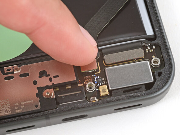

  35. Google Pixel 10 Battery Replacement, Connect the interconnect cable: 35 단계, 이미지 2개 중 1개 Google Pixel 10 Battery Replacement, Connect the interconnect cable: 35 단계, 이미지 2개 중 2개
    • Use your finger to press down and reconnect the interconnect cable press connector to its socket on the motherboard.

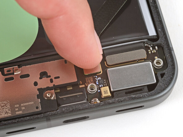

  36. Google Pixel 10 Battery Replacement: 36 단계, 이미지 2개 중 1개 Google Pixel 10 Battery Replacement: 36 단계, 이미지 2개 중 2개
    • Use your finger to press down and reconnect the interconnect cable press connector to its socket on the USB‑C board.

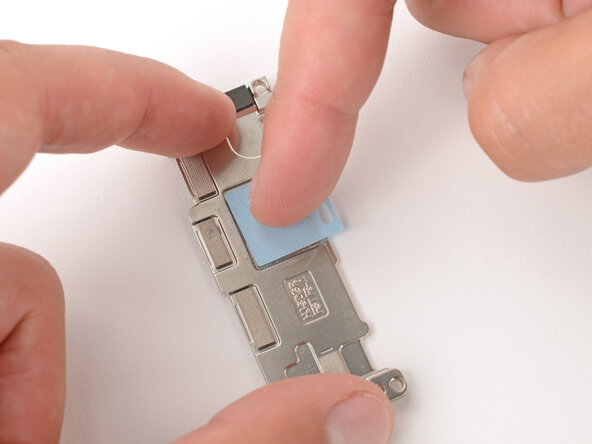

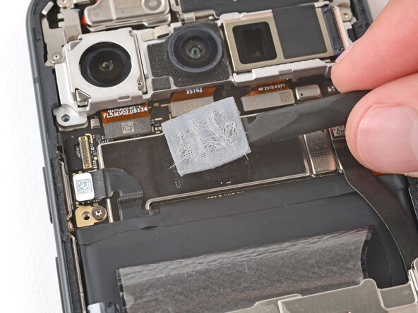

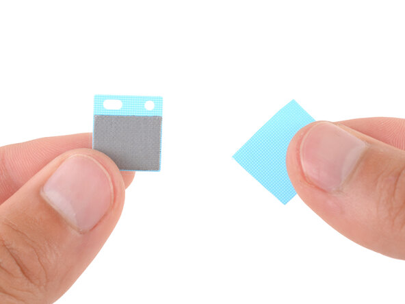

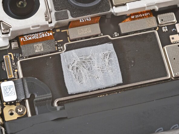

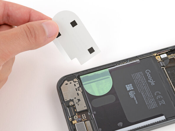

  39. Google Pixel 10 Battery Replacement, Replace the thermal pad: 39 단계, 이미지 3개 중 1개 Google Pixel 10 Battery Replacement, Replace the thermal pad: 39 단계, 이미지 3개 중 2개 Google Pixel 10 Battery Replacement, Replace the thermal pad: 39 단계, 이미지 3개 중 3개
    • Check the condition of the motherboard thermal pad—it'll either be on the bottom edge of the board or on the underside of the cover.
    • If the thermal pad is damaged, follow the next three steps to replace it. Otherwise, skip down three steps.

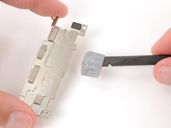

    • Use the flat end of a spudger to gently scrape up and remove all the old thermal pad from the board and cover.
  40. Google Pixel 10 Battery Replacement: 40 단계, 이미지 2개 중 1개 Google Pixel 10 Battery Replacement: 40 단계, 이미지 2개 중 2개
    • Use high‑concentration (>90%) isopropyl alcohol and a coffee filter (or lint‑free cloth) to clean up any thermal pad residue from the board and cover.
    • Allow the alcohol to dry completely before continuing.
  41. Google Pixel 10 Battery Replacement: 41 단계, 이미지 3개 중 1개 Google Pixel 10 Battery Replacement: 41 단계, 이미지 3개 중 2개 Google Pixel 10 Battery Replacement: 41 단계, 이미지 3개 중 3개
    • Remove the larger liner (without cutouts) from the thermal pad.
    • Lay the thermal pad in its square cutout on the underside of the motherboard cover.
    • Press down firmly on the entire surface of the pad with your finger or the flat end of a spudger.
    • Slowly peel up the remaining liner.
    • If the pad starts to peel up with the liner, press it back into place and try again.

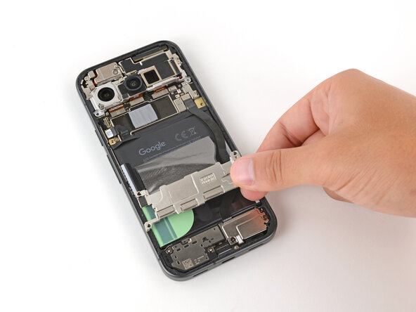

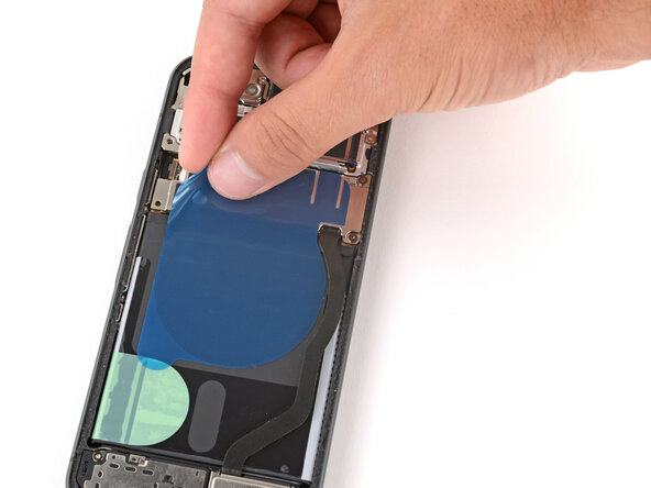

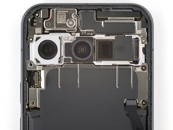

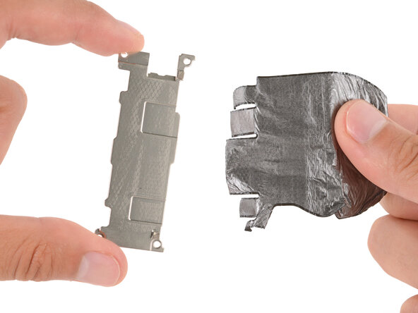

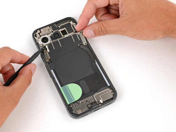

  43. Google Pixel 10 Battery Replacement, Check the graphite sheet: 43 단계, 이미지 2개 중 1개 Google Pixel 10 Battery Replacement, Check the graphite sheet: 43 단계, 이미지 2개 중 2개
    • Check the condition of the graphite sheet attached to the motherboard cover.
    • If the sheet is torn or damaged in any way, peel it up and remove it from the cover—you'll apply a new one in a few steps.
  44. Google Pixel 10 Battery Replacement, Install the motherboard cover: 44 단계, 이미지 2개 중 1개 Google Pixel 10 Battery Replacement, Install the motherboard cover: 44 단계, 이미지 2개 중 2개
    • Put the motherboard cover back in place.

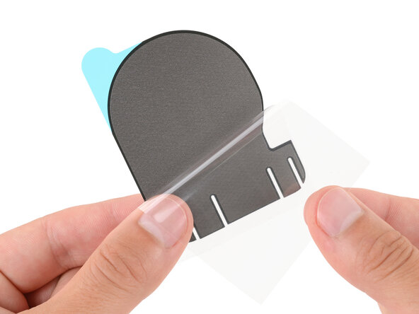

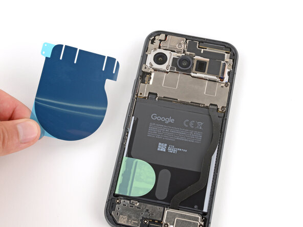

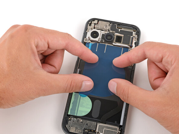

  46. Google Pixel 10 Battery Replacement, Prepare the graphite sheet: 46 단계, 이미지 1개 중 1개
    • Remove the large clear liner from the graphite sheet, exposing the adhesive.
  47. Google Pixel 10 Battery Replacement, Install the graphite sheet: 47 단계, 이미지 3개 중 1개 Google Pixel 10 Battery Replacement, Install the graphite sheet: 47 단계, 이미지 3개 중 2개 Google Pixel 10 Battery Replacement, Install the graphite sheet: 47 단계, 이미지 3개 중 3개
    • Lay the graphite sheet into place, so the circular portion is over the battery, and the cutouts on the top edge go into the grooves on the motherboard cover.
    • Use your fingers to press down firmly on the entire surface of the sheet to secure it.
  48. Google Pixel 10 Battery Replacement: 48 단계, 이미지 3개 중 1개 Google Pixel 10 Battery Replacement: 48 단계, 이미지 3개 중 2개 Google Pixel 10 Battery Replacement: 48 단계, 이미지 3개 중 3개
    • Slowly peel up and remove the remaining liner.
    • If the sheet starts to peel up with the liner, press it back into place and try again.

  53. Google Pixel 10 Battery Replacement, Orient the adhesive: 53 단계, 이미지 2개 중 1개 Google Pixel 10 Battery Replacement, Orient the adhesive: 53 단계, 이미지 2개 중 2개
    • Before applying the back glass adhesive, make sure you know how it will sit on the frame. If you apply the adhesive incorrectly, you'll need to restart with new adhesive.
    • Hold the adhesive above the frame to find its orientation. Use the rear camera cutout in the liner to help visualize how it will lay in the frame.
  54. Google Pixel 10 Battery Replacement: 54 단계, 이미지 1개 중 1개
    • Peel down the top half of the large, clear liner to expose the adhesive—don't fully remove the liner yet.
  55. Google Pixel 10 Battery Replacement, Install the back glass adhesive: 55 단계, 이미지 3개 중 1개 Google Pixel 10 Battery Replacement, Install the back glass adhesive: 55 단계, 이미지 3개 중 2개 Google Pixel 10 Battery Replacement, Install the back glass adhesive: 55 단계, 이미지 3개 중 3개
    • Take your time aligning the adhesive with the frame—it's very sticky and can't be moved after you apply it.
    • With the larger, clear liner folded towards the bottom of the phone, lay the exposed top edge of the adhesive onto the frame.
    • Use the lip of the frame to help align the adhesive.
    • Once the top edge is properly aligned, gently press down on the top corners to secure the adhesive.
  56. Google Pixel 10 Battery Replacement: 56 단계, 이미지 3개 중 1개 Google Pixel 10 Battery Replacement: 56 단계, 이미지 3개 중 2개 Google Pixel 10 Battery Replacement: 56 단계, 이미지 3개 중 3개
    • Slowly lay the rest of the adhesive onto the frame, pressing it into place and peeling away the larger liner as you go.

  62. Google Pixel 10 Battery Replacement, Connect the back glass cable: 62 단계, 이미지 2개 중 1개 Google Pixel 10 Battery Replacement, Connect the back glass cable: 62 단계, 이미지 2개 중 2개
    • Use the flat end of a spudger to connect the back glass press connector to its socket.
    • This can be tricky, as there's very little play in the cable. Move the back glass as necessary to help, and don't try to force the connector into place—reposition it and try again.
  63. Google Pixel 10 Battery Replacement, Install the bracket: 63 단계, 이미지 3개 중 1개 Google Pixel 10 Battery Replacement, Install the bracket: 63 단계, 이미지 3개 중 2개 Google Pixel 10 Battery Replacement, Install the bracket: 63 단계, 이미지 3개 중 3개
    • Put the cable's bracket back in place, making sure the tab on the right edge goes under its groove.
  64. Google Pixel 10 Battery Replacement: 64 단계, 이미지 2개 중 1개 Google Pixel 10 Battery Replacement: 64 단계, 이미지 2개 중 2개
    • Use a Torx Plus 3IP screwdriver to install the two 5.0 mm‑long screws securing the bracket.
    • This is a good point to power on your device and test all functions before sealing it up. If you have trouble, try some basic troubleshooting. Be sure to power back down completely before you continue working.
  65. Google Pixel 10 Battery Replacement, Remove the remaining liners: 65 단계, 이미지 3개 중 1개 Google Pixel 10 Battery Replacement, Remove the remaining liners: 65 단계, 이미지 3개 중 2개 Google Pixel 10 Battery Replacement, Remove the remaining liners: 65 단계, 이미지 3개 중 3개
    • Remove the remaining liners from the back glass adhesive.
    • If the adhesive starts to peel up with the liner, check that you’ve pushed all of it into place with your spudger. If it continues to peel up, hold it down with the point of your spudger as you go.
