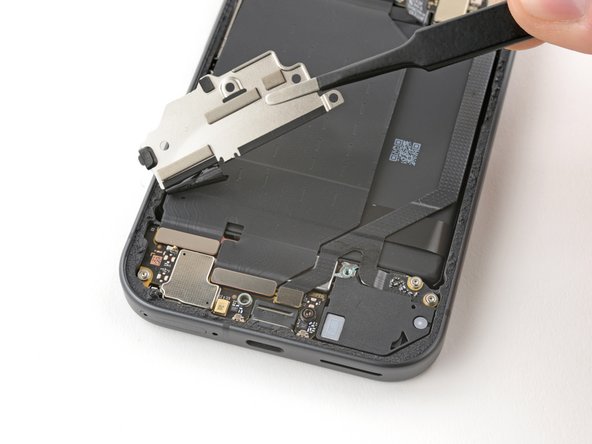

  15. Google Pixel 9 Battery Replacement, Remove the charging board cover: 15 단계, 이미지 1개 중 1개
    • Use a 3IP Torx Plus driver to remove the two screws securing the charging board cover:
    • One 5.4 mm-long screw
    • One 2.9 mm-long screw
  16. Google Pixel 9 Battery Replacement: 16 단계, 이미지 3개 중 1개 Google Pixel 9 Battery Replacement: 16 단계, 이미지 3개 중 2개 Google Pixel 9 Battery Replacement: 16 단계, 이미지 3개 중 3개
    • A small plastic tab keeps the cover secured under the left edge of the frame.
    • Use a pair of tweezers to slide the cover out from under the lip on the edge of the frame.
    • Flip the cover over, off of the charging board.

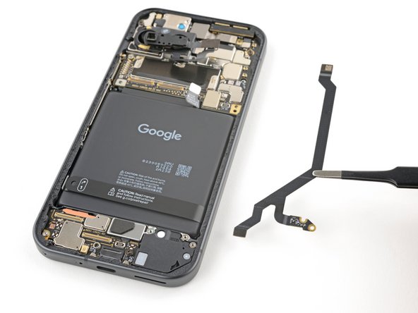

  19. Google Pixel 9 Battery Replacement, Remove the interconnect cable: 19 단계, 이미지 3개 중 1개 Google Pixel 9 Battery Replacement, Remove the interconnect cable: 19 단계, 이미지 3개 중 2개 Google Pixel 9 Battery Replacement, Remove the interconnect cable: 19 단계, 이미지 3개 중 3개
    • Disconnect the bottom two interconnect cable press connectors from the charging board.
    • Remove the interconnect cable.

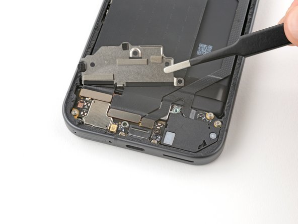

  22. Google Pixel 9 Battery Replacement, Remove the antenna board cover: 22 단계, 이미지 1개 중 1개
    • Use a 3IP Torx Plus driver to remove the 5.4 mm-long screw securing the antenna board cover.
  23. Google Pixel 9 Battery Replacement: 23 단계, 이미지 1개 중 1개
    • Use a pair of tweezers to remove the antenna board cover.

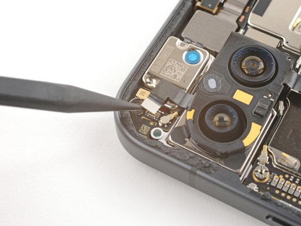

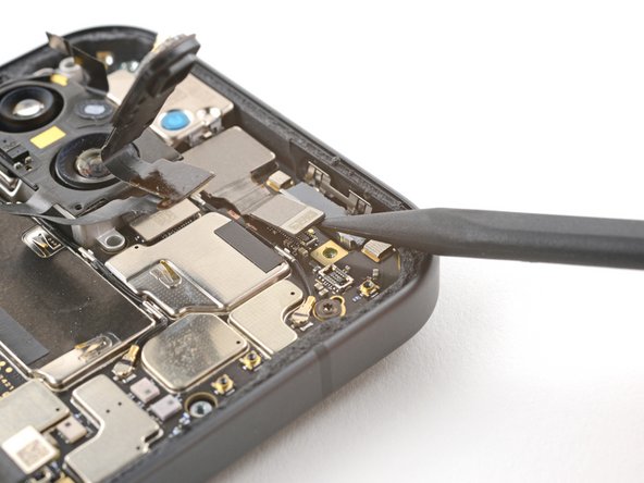

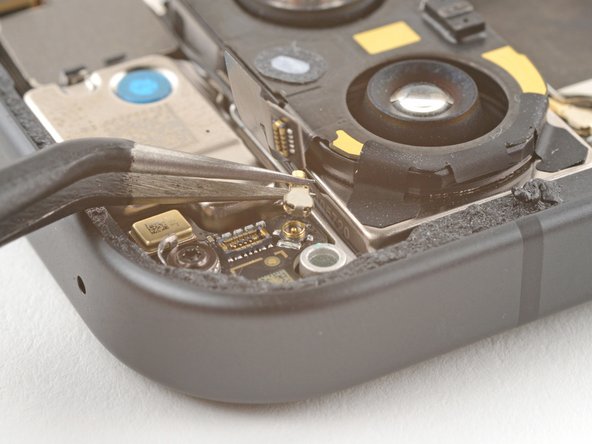

  25. Google Pixel 9 Battery Replacement, Disconnect the antenna cable: 25 단계, 이미지 2개 중 1개 Google Pixel 9 Battery Replacement, Disconnect the antenna cable: 25 단계, 이미지 2개 중 2개
    • Insert one arm of a pair of angled tweezers under the neck of the antenna board's coaxial antenna cable.
    • Lift straight up to disconnect the antenna.

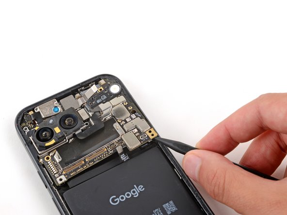

  28. Google Pixel 9 Battery Replacement, Remove the motherboard: 28 단계, 이미지 3개 중 1개 Google Pixel 9 Battery Replacement, Remove the motherboard: 28 단계, 이미지 3개 중 2개 Google Pixel 9 Battery Replacement, Remove the motherboard: 28 단계, 이미지 3개 중 3개
    • Insert the tip of a spudger underneath the bottom right corner of the motherboard.
    • Use your spudger to lift the motherboard until you can grip the right edge with your fingers.
    • Grip the right edge of the motherboard and remove it.

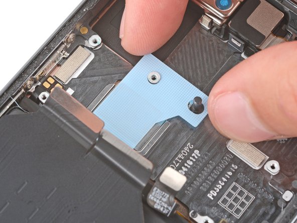

  29. Google Pixel 9 Battery Replacement, Thermal pad reassembly information: 29 단계, 이미지 3개 중 1개 Google Pixel 9 Battery Replacement, Thermal pad reassembly information: 29 단계, 이미지 3개 중 2개 Google Pixel 9 Battery Replacement, Thermal pad reassembly information: 29 단계, 이미지 3개 중 3개
    • During reassembly:
    • Check the condition of the logic board thermal pad—it will either be on the bottom of the logic board or on the frame.
    • If the pad is undamaged, skip the rest of this step.
    • If the pad is damaged, use the flat end of a spudger to scrape it up and remove it.
    • Use isopropyl alcohol (greater than 90%) and a microfiber cloth to remove all thermal pad residue from the frame and bottom of the logic board.
    • Apply a new thermal pad to its spot on the frame.

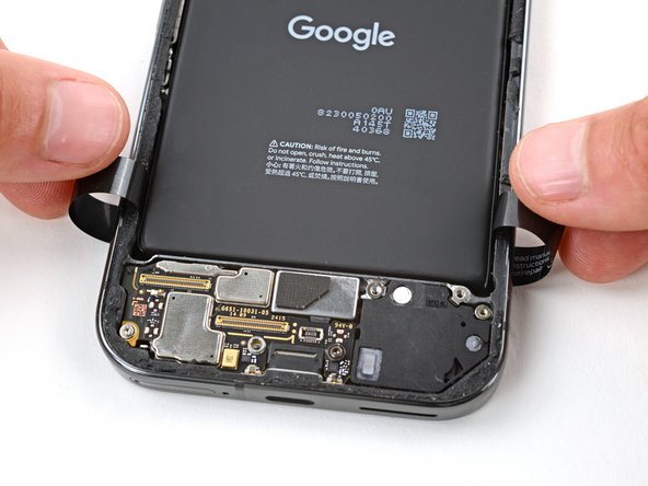

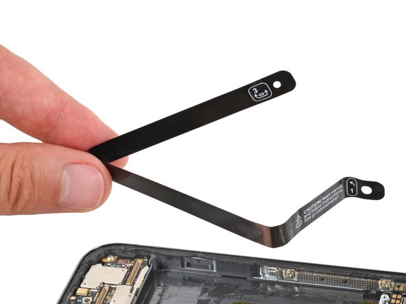

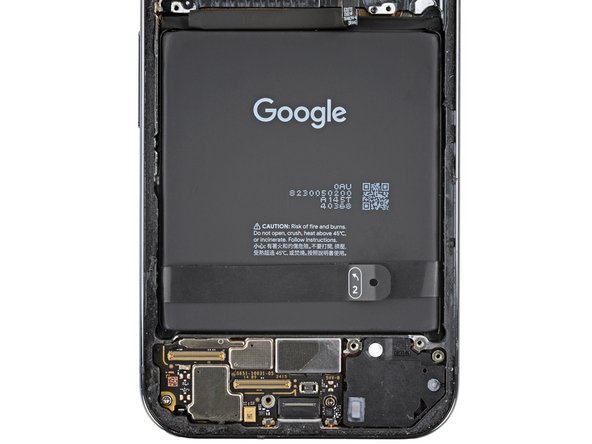

  30. Google Pixel 9 Battery Replacement, Detach the battery pull tabs: 30 단계, 이미지 3개 중 1개 Google Pixel 9 Battery Replacement, Detach the battery pull tabs: 30 단계, 이미지 3개 중 2개 Google Pixel 9 Battery Replacement, Detach the battery pull tabs: 30 단계, 이미지 3개 중 3개
    이 단계에 사용된 도구:
    Finger Stalls
    $8.99
    • Use your fingers to peel up the plastic tabs near the bottom edge of the battery.
    • Fold the tabs under the phone or tape them out of the way so they don't warp when heating the battery in the next step.
    • Wear finger stalls to help get a solid grip on the battery pull tabs in the next few steps.
    • If you don't have finger stalls, you can use rubber gloves instead.

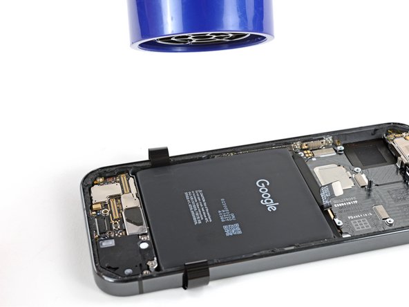

  31. Google Pixel 9 Battery Replacement, Heat the battery: 31 단계, 이미지 3개 중 1개 Google Pixel 9 Battery Replacement, Heat the battery: 31 단계, 이미지 3개 중 2개 Google Pixel 9 Battery Replacement, Heat the battery: 31 단계, 이미지 3개 중 3개
    • Before starting the battery removal process, carefully read the next three steps. The pull tabs are most effective immediately after heating the battery, so you'll want to know exactly what to do before starting the process.
    • Strong strips of adhesive secure the battery to the frame. Heating the battery will soften the adhesive, making it easier to separate.
    • Use a hair dryer on High heat and Low speed settings to heat the battery for three minutes, while holding the hair dryer about three inches from the battery. Try to evenly spread the heat over the entire surface of the battery.
    • Alternatively, you can use a heat mat at 70 °C (158 °F) with your phone placed screen side down for 10 minutes.

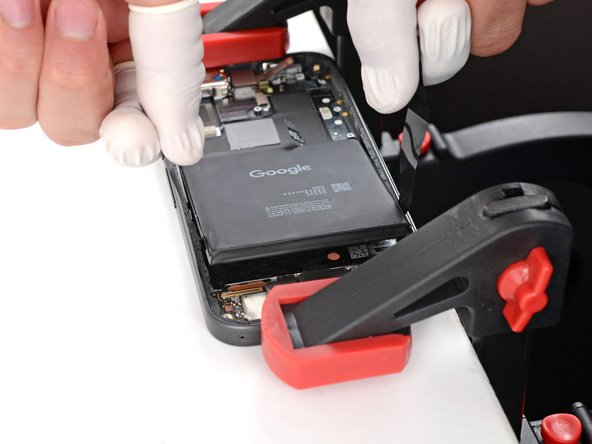

  32. Google Pixel 9 Battery Replacement, Secure the phone to your work surface: 32 단계, 이미지 2개 중 1개 Google Pixel 9 Battery Replacement, Secure the phone to your work surface: 32 단계, 이미지 2개 중 2개
    이 단계에 사용된 도구:
    Heavy-Duty F-Clamp
    $13.99
    • Since the battery pull tabs require two hands, you'll need to firmly secure the phone to your work surface.
    • Before securing your phone, make sure nothing is under it. Only secure the phone by the raised lip of the frame, and be very careful not to press down on any internal components.
    • Move the pull tabs out from under your phone so they're accessible.
    • Use F‑Clamps or C‑Clamps to secure the phone to your work surface. At minimum, you'll need two clamps—one for the top edge and one for the bottom edge.
    • Use clamps with plastic or rubber pads, or be extra careful not to scuff your device.
    • If you don't have any clamps, have a friend hold the phone firmly in place.
    • Make sure to follow ESD precautions when securing the phone.

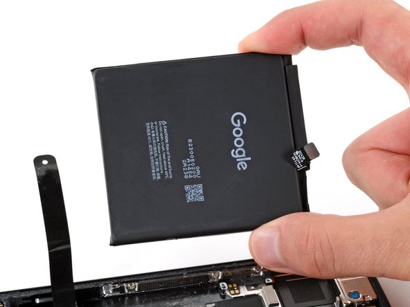

  33. Google Pixel 9 Battery Replacement, Separate the battery adhesive: 33 단계, 이미지 3개 중 1개 Google Pixel 9 Battery Replacement, Separate the battery adhesive: 33 단계, 이미지 3개 중 2개 Google Pixel 9 Battery Replacement, Separate the battery adhesive: 33 단계, 이미지 3개 중 3개
    • Pull straight up on the battery pull tabs and apply constant, steady pressure until the battery separates from the frame.
    • If the battery doesn't separate after one minute of steady pressure, apply more heat and try again.
    • Remove the battery.
    • Never reuse a deformed or damaged battery—it's a fire hazard. Replace it with a new battery.
    • If you successfully removed the battery, congratulations! Skip down seven steps for reassembly information.
    • If the pull tab broke or accidentally slipped out from under the battery, don't worry! Go to the next step for an alternate battery removal method.

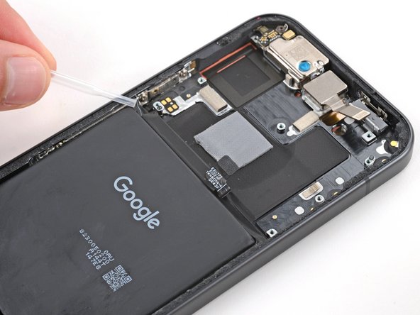

  34. Google Pixel 9 Battery Replacement, Apply isopropyl alcohol: 34 단계, 이미지 2개 중 1개 Google Pixel 9 Battery Replacement, Apply isopropyl alcohol: 34 단계, 이미지 2개 중 2개
    • During the next two steps, don't apply more isopropyl alcohol than instructed, or you may damage your screen.
    • Apply two or three drops of isopropyl alcohol (greater than 90%) to the top corners of the battery.
  35. Google Pixel 9 Battery Replacement: 35 단계, 이미지 2개 중 1개 Google Pixel 9 Battery Replacement: 35 단계, 이미지 2개 중 2개
    • Apply two or three drops of isopropyl alcohol (greater than 90%) to the bottom corners of the battery.
    • Wait one minute to allow the alcohol to soften the battery adhesive.

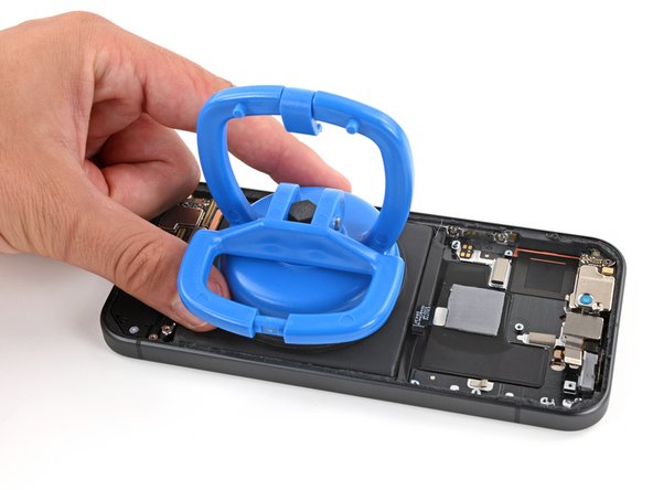

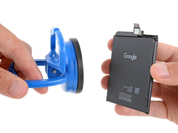

  36. Google Pixel 9 Battery Replacement, Apply a large suction cup: 36 단계, 이미지 3개 중 1개 Google Pixel 9 Battery Replacement, Apply a large suction cup: 36 단계, 이미지 3개 중 2개 Google Pixel 9 Battery Replacement, Apply a large suction cup: 36 단계, 이미지 3개 중 3개
    이 단계에 사용된 도구:
    Heavy-Duty Suction Cups (Pair)
    $14.95
    • A heavy‑duty suction cup works very well for battery removal, but you can also use a smaller suction handle. If you're using the smaller suction handle, apply it to the top edge of the battery and skip down two steps.
    • Pull the handle on the large suction cup down to open it.
    • Use your fingers to fold the plastic battery tabs fully out of the way of the battery.
    • Place the suction cup in the center of the battery.

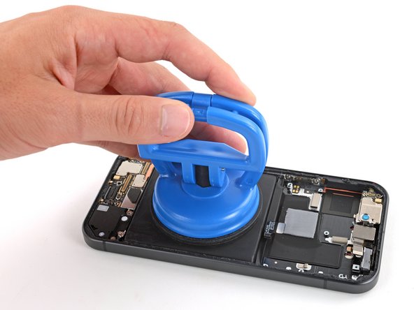

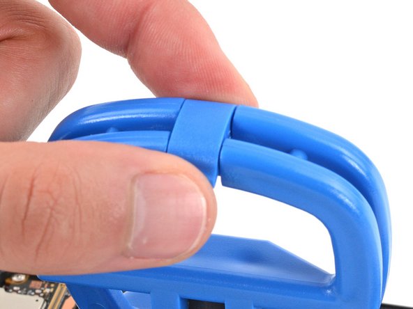

  37. Google Pixel 9 Battery Replacement: 37 단계, 이미지 3개 중 1개 Google Pixel 9 Battery Replacement: 37 단계, 이미지 3개 중 2개 Google Pixel 9 Battery Replacement: 37 단계, 이미지 3개 중 3개
    • While gently pressing down on the suction cup, pull the handle up to lock it.
    • Flip the plastic clip on top of the suction cup over the handle and clip it to latch the handles together.
  38. Google Pixel 9 Battery Replacement: 38 단계, 이미지 2개 중 1개 Google Pixel 9 Battery Replacement: 38 단계, 이미지 2개 중 2개
    • With one hand, firmly secure the phone to your work surface.
    • With your free hand, pull the suction cup towards the bottom of your phone with strong, steady force to lift the top edge of the battery. Apply constant pressure with the suction cup to allow time for the adhesive to separate.
    • If the battery doesn't budge after one minute, apply two to three drops of alcohol to the corners of the battery and try again. It may take multiple cycles of alcohol and steady pressure to detach the battery.
  39. Google Pixel 9 Battery Replacement, Remove the battery: 39 단계, 이미지 3개 중 1개 Google Pixel 9 Battery Replacement, Remove the battery: 39 단계, 이미지 3개 중 2개 Google Pixel 9 Battery Replacement, Remove the battery: 39 단계, 이미지 3개 중 3개
    • Remove the battery from its recess.
    • Take the suction cup off the battery.
    • If the battery pull tab stayed in the recess, remove it.

    • Remove any tape or liners from the battery cable.
    • Remove the larger plastic liner from the bottom of the battery to expose the adhesive.
    • If your battery doesn't have adhesive pre‑installed, apply strips of thin, double‑sided tape to the frame where the old adhesive was.
    • Firmly press the battery into its recess to secure it with the adhesive.
