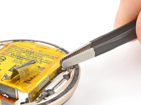

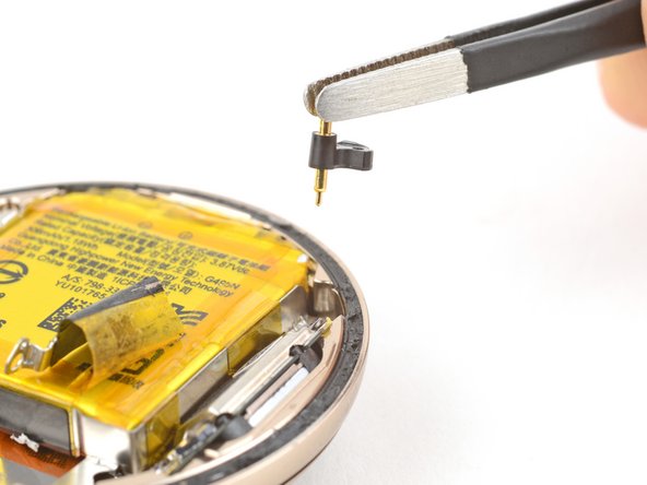

  12. Google Pixel Watch 2 Battery Replacement, Peel up the vibration motor cable tape: 12 단계, 이미지 3개 중 1개 Google Pixel Watch 2 Battery Replacement, Peel up the vibration motor cable tape: 12 단계, 이미지 3개 중 2개 Google Pixel Watch 2 Battery Replacement, Peel up the vibration motor cable tape: 12 단계, 이미지 3개 중 3개
    • Tape secures the vibration motor cable and its cover to the battery.
    • Be careful not to puncture the battery—it can leak dangerous chemicals and catch fire.
    • Use a pair of blunt nose tweezers to grip the vibration motor press connector cover.
    • Gently peel up the tape until the vibration motor cable is uncovered.
    • During reassembly, use the flat end of a spudger to push the black cover tape back into place.

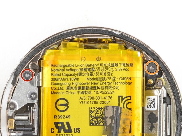

  17. Google Pixel Watch 2 Battery Replacement, Unfasten the battery: 17 단계, 이미지 2개 중 1개 Google Pixel Watch 2 Battery Replacement, Unfasten the battery: 17 단계, 이미지 2개 중 2개
    • Use a 1IP Torx Plus screwdriver to remove the two screws securing the battery:
    • One 2 mm‑long screw
    • One 3 mm‑long screw, also securing a grounding bracket

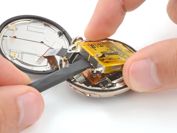

  19. Google Pixel Watch 2 Battery Replacement, Pry up the battery: 19 단계, 이미지 2개 중 1개 Google Pixel Watch 2 Battery Replacement, Pry up the battery: 19 단계, 이미지 2개 중 2개
    • Light adhesive secures the battery in place.
    • Insert the flat end of a spudger under the top edge of the battery.
    • Pry the battery up to separate the adhesive.
    • Don't try to remove the battery yet, as it's still connected to the watch with a delicate cable.

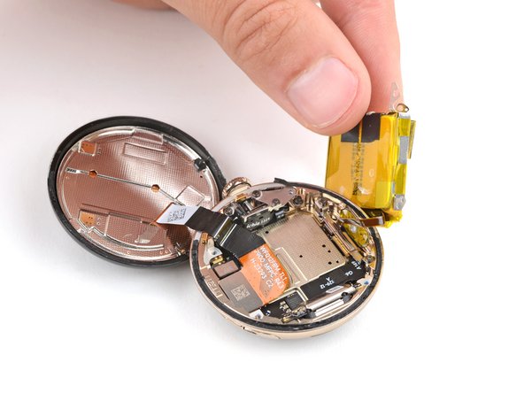

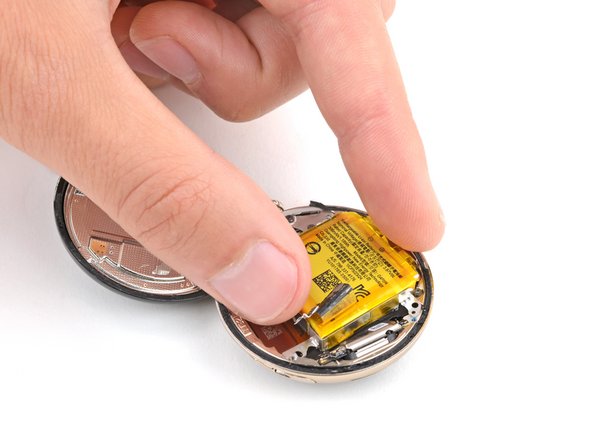

  20. Google Pixel Watch 2 Battery Replacement, Reposition the battery: 20 단계, 이미지 3개 중 1개 Google Pixel Watch 2 Battery Replacement, Reposition the battery: 20 단계, 이미지 3개 중 2개 Google Pixel Watch 2 Battery Replacement, Reposition the battery: 20 단계, 이미지 3개 중 3개
    • Lift the battery out of its recess and set it next to your watch so you can access the battery connector.
    • Be careful not to strain the battery cable.

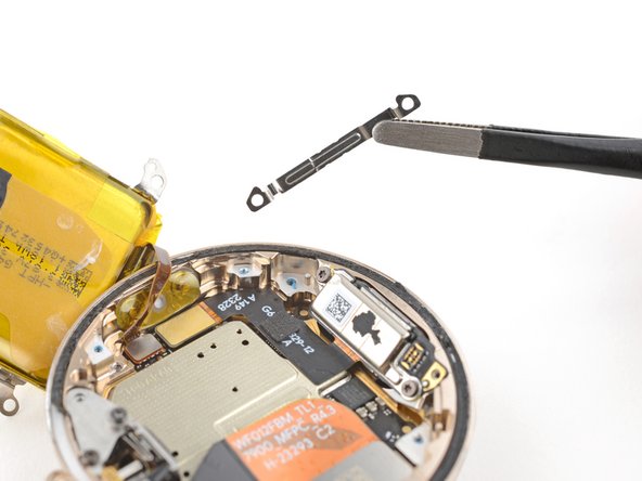

  21. Google Pixel Watch 2 Battery Replacement, Unfasten the battery connector bracket: 21 단계, 이미지 2개 중 1개 Google Pixel Watch 2 Battery Replacement, Unfasten the battery connector bracket: 21 단계, 이미지 2개 중 2개
    • Use a 1IP Torx Plus screwdriver to remove the two 2 mm‑long screws securing the battery connector bracket.
  22. Google Pixel Watch 2 Battery Replacement, Remove the battery cable bracket: 22 단계, 이미지 1개 중 1개
    • Use tweezers to remove the battery connector bracket.

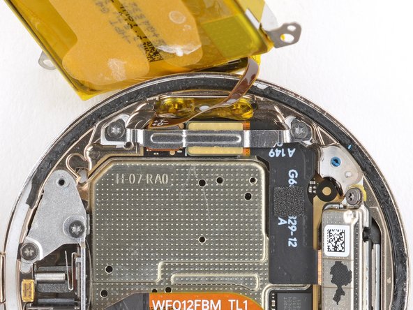

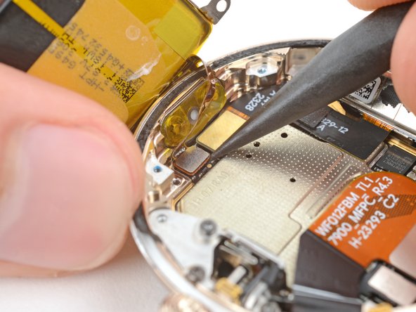

  23. Google Pixel Watch 2 Battery Replacement, Disconnect the battery: 23 단계, 이미지 3개 중 1개 Google Pixel Watch 2 Battery Replacement, Disconnect the battery: 23 단계, 이미지 3개 중 2개 Google Pixel Watch 2 Battery Replacement, Disconnect the battery: 23 단계, 이미지 3개 중 3개
    • Use the point of a spudger to pry up and disconnect the battery press connector.
    • During reassembly, hold the battery above the watch while reconnecting it. Make sure the press connector is oriented so the cable is facing outward.

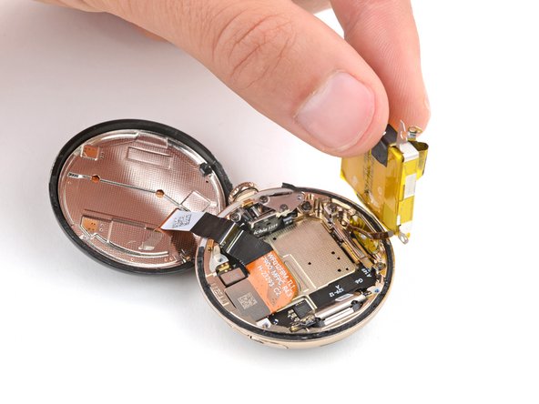

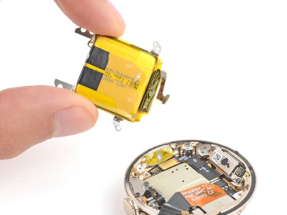

  24. Google Pixel Watch 2 Battery Replacement, Remove the battery: 24 단계, 이미지 1개 중 1개
    • Remove the battery.
    • If your battery is bent, creased, or deformed in any way, don't reuse it. Replace it with a new battery.
    • If your replacement battery doesn't come installed in a bracket, transfer the bracket from your old battery to the new one.
