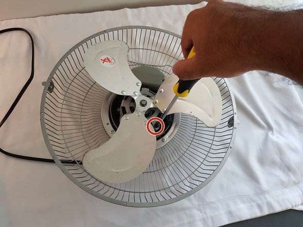

    • Expose the four screws on the impeller assembly by turning the blades.
    • Pick one screw and tighten it a small amount by rotating the screw just once with a Phillips #2 screwdriver.

    • To ensure that the blades do not move, use one hand to keep them in place.
    • Tighten the set screw between the blades and impeller assembly using a Phillips #2 screwdriver.
    • The set screw is a little hard to reach, so it is crucial to keep the blades still.
  11. How to Fix a Wobbly Westinghouse 12-inch High Velocity Fan: 11 단계, 이미지 3개 중 1개 How to Fix a Wobbly Westinghouse 12-inch High Velocity Fan: 11 단계, 이미지 3개 중 2개 How to Fix a Wobbly Westinghouse 12-inch High Velocity Fan: 11 단계, 이미지 3개 중 3개
    • Check the tightness of the set screw by pulling the blades up gently.
    • The blades should only lift a minuscule amount when you perform this test. If they do not move at all, the set screw is too tight.
