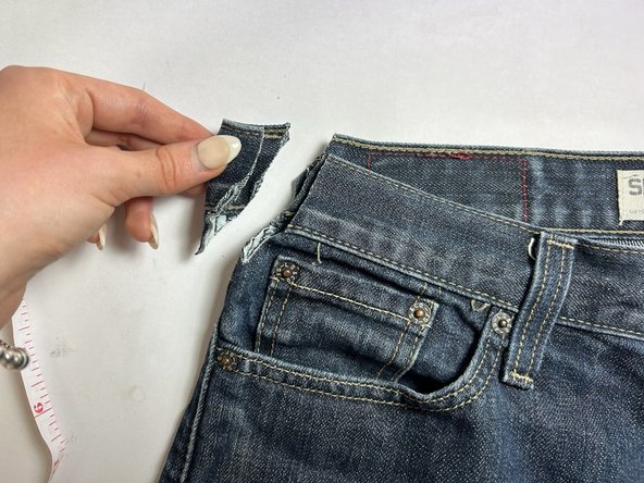

    • Lay the jeans on a flat surface.
    • Use a measuring tape to measure the waistband of the jeans from one hip to hip.
  2. How to Increase the Waist Size of Jeans: 2 단계, 이미지 1개 중 1개
    • With the measuring tape, measure your own waistline from hip to hip.
  3. How to Increase the Waist Size of Jeans: 3 단계, 이미지 1개 중 1개
    • Calculate the difference between your waistline and the waistband measurements.
    • Mark 1/4 of the difference on each side of the waistband with a pencil.
    • For example, if the difference is 1 inch, mark 1/4 inch on each hip.
  4. How to Increase the Waist Size of Jeans: 4 단계, 이미지 2개 중 1개 How to Increase the Waist Size of Jeans: 4 단계, 이미지 2개 중 2개
    • Use sewing scissors to cut from 1/2 inch below the waistband to the marking made in Step 3.
    • Scissors may be sharp and should be used carefully.
  5. How to Increase the Waist Size of Jeans: 5 단계, 이미지 2개 중 1개 How to Increase the Waist Size of Jeans: 5 단계, 이미지 2개 중 2개
    • Measure the elastic to fit the space that was removed from the waistband with an extra 1/2 inch on each end.
    • Cut the elastic where it was measured.
  6. How to Increase the Waist Size of Jeans: 6 단계, 이미지 2개 중 1개 How to Increase the Waist Size of Jeans: 6 단계, 이미지 2개 중 2개
    • Insert an arms-length piece of thread through the needle's eye.
    • Pull it through the needle so both ends of the thread meet.
    • Tie a knot at the end of the thread.
    • The sewing needle is sharp and should be used carefully.
  7. How to Increase the Waist Size of Jeans: 7 단계, 이미지 2개 중 1개 How to Increase the Waist Size of Jeans: 7 단계, 이미지 2개 중 2개
    • Sew each end of the elastic on the inside of the waistband.
    • This can be done by inserting the needle back and forth through the elastic and jean waistband. Refer to this guide for information on how to hand sew a straight stitch.
  8. How to Increase the Waist Size of Jeans: 8 단계, 이미지 1개 중 1개
    • Tie a knot at the end of the thread when you finish sewing. Cut off the excess thread.
    • Repeat steps 3-8 on the alternate side of the waistband.
