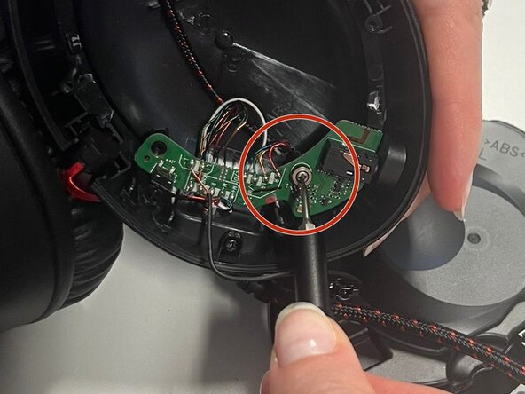

    3. HyperX Cloud III Connecting Cable Replacement: 4 단계, 이미지 2개 중 1개 HyperX Cloud III Connecting Cable Replacement: 4 단계, 이미지 2개 중 2개
      • Use the Phillips #2 screwdriver to remove the two 6.8 mm-long screws securing the motherboard.
