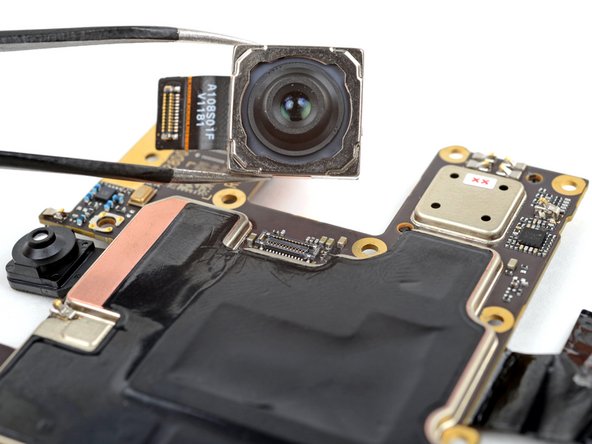

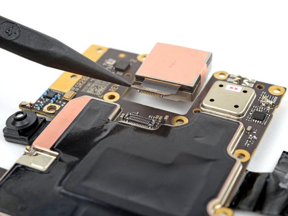

  31. Motorola Edge 5G UW (2022) Main Camera Replacement, Remove the main camera: 31 단계, 이미지 3개 중 1개 Motorola Edge 5G UW (2022) Main Camera Replacement, Remove the main camera: 31 단계, 이미지 3개 중 2개 Motorola Edge 5G UW (2022) Main Camera Replacement, Remove the main camera: 31 단계, 이미지 3개 중 3개
    • Flip the motherboard over to access the main camera's press connector.
    • Use the pointed end of a spudger to pry up and disconnect the main camera's press connector.
    • There's no adhesive securing the main camera to the motherboard. Be careful disconnecting the press connector, as it may eject the camera.
    • Remove the camera.
