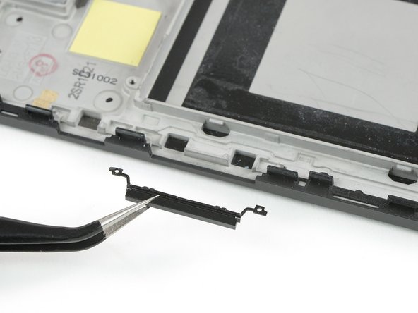

  20. Nexus 5X Screen Assembly Replacement: 20 단계, 이미지 2개 중 1개 Nexus 5X Screen Assembly Replacement: 20 단계, 이미지 2개 중 2개
    • Free the rubber feet of the volume button with a pair of tweezers and lift it upwards.
    • Remove the volume button.
    • You can find spare button parts here if your buttons are damaged, or if you want to exchange them for cosmetic reasons.

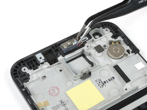

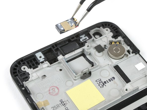

  21. Nexus 5X Screen Assembly Replacement: 21 단계, 이미지 3개 중 1개 Nexus 5X Screen Assembly Replacement: 21 단계, 이미지 3개 중 2개 Nexus 5X Screen Assembly Replacement: 21 단계, 이미지 3개 중 3개
    • Use a pair of tweezers to gently peel of the tape that holds down the earpiece speaker.
    • Use the tweezers to carefully lift the earpiece speaker out of its gasket.
    • In case you're having trouble removing the earpiece speaker you can use an iOpener to loosen the adhesive beneath.
    • Remove the earpiece speaker.
    • Note the earpiece speaker orientation. Be sure to reinstall it the same direction.
