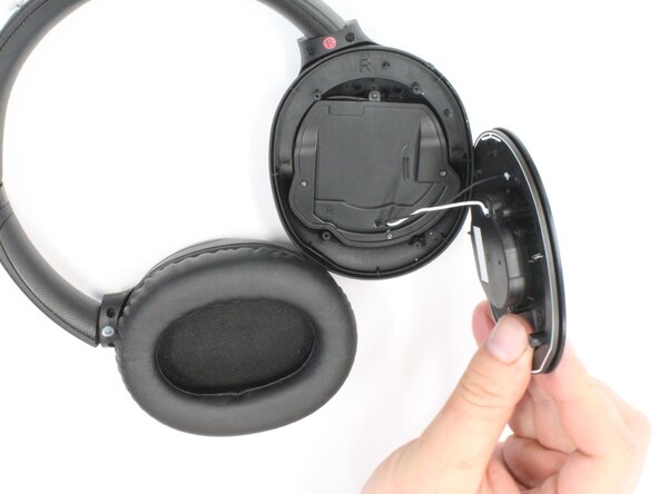

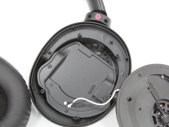

    5. Sony WH-CH710N Battery Replacement: 5 단계, 이미지 2개 중 1개 Sony WH-CH710N Battery Replacement: 5 단계, 이미지 2개 중 2개
      • Gently grasp the black inner ear plate and pull it away from the cup of the earphone, exposing the internal components.
      • The internal components are still attached to the wires, which are glued into the inner ear plate. Be extremely careful not to pull on the wires while performing this step.

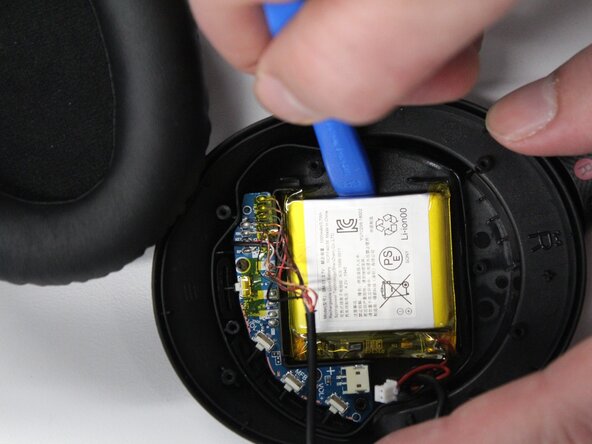

    2. Sony WH-CH710N Battery Replacement: 7 단계, 이미지 3개 중 1개 Sony WH-CH710N Battery Replacement: 7 단계, 이미지 3개 중 2개 Sony WH-CH710N Battery Replacement: 7 단계, 이미지 3개 중 3개
      • Insert some isopropyl alcohol or adhesive remover underneath the battery to soften the adhesive.
      • Gently slide a plastic opening pick around the edges of the battery to loosen the adhesive before you remove it.
      • Use a suction cup to lift the battery out.
      • Don't pry the battery as this can cause an explosion or fire.
