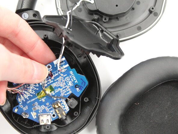

    5. Sony WH-CH710N Charging Port Replacement: 5 단계, 이미지 1개 중 1개
      • Gently grasp the black inner ear plate and pull it away from the ear cup, exposing the internal components.
      • The internal components are still attached to the wires, which are glued into the inner ear plate. Be extremely careful not to pull on the wires while performing this step.

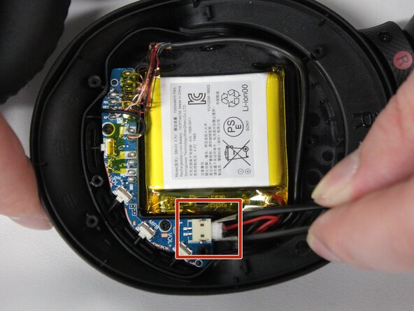

    1. Sony WH-CH710N Charging Port Replacement, Sony WH-CH710N Charging Port: 11 단계, 이미지 1개 중 1개
      • Push on alternating sides of the JST connector, to release it.
      • If that doesn't work, use a pair of tweezers to firmly grip the sides of the battery connector and pull straight away from the socket. Hold the tweezers closer to the connector to get a better grip.
      • Avoid scratching the circuit board or damaging any wires in the process.
      • If this step is not performed, the cord connected to the circuit board may still carry an electrical current, creating a risk of electric shock or damage to the board.

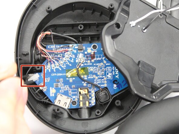

    2. Sony WH-CH710N Charging Port Replacement: 12 단계, 이미지 1개 중 1개
      • Return to the left ear cup of the headphones and locate the charging port.
      댓글 쓰기
