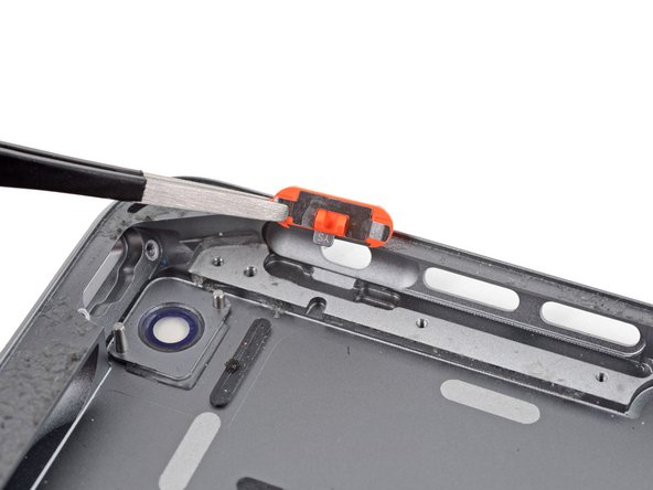

  140. iPad Air Wi-Fi Rear Case Replacement: 140 단계, 이미지 2개 중 1개 iPad Air Wi-Fi Rear Case Replacement: 140 단계, 이미지 2개 중 2개
    • Use a set of tweezers to remove the rotation lock/mute switch from the rear case.
    • Note the orientation for reassembly: the small gray tab should line up with the groove in the rear case.
    • The 5th generation iPad does not have this switch.
