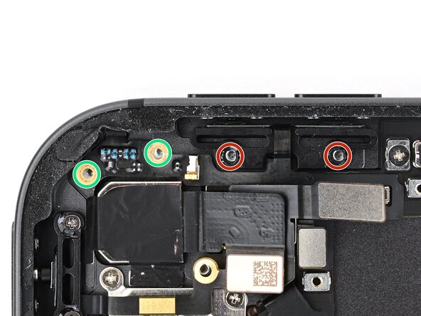

  29. iPad Pro 13" Volume Buttons Replacement, Remove the volume buttons screws: 29 단계, 이미지 2개 중 1개 iPad Pro 13" Volume Buttons Replacement, Remove the volume buttons screws: 29 단계, 이미지 2개 중 2개
    • Use a JCIS or JIS 00 screwdriver to remove four screws securing the volume buttons:
    • Two 2.0 mm‑long screws securing the volume buttons bracket
    • Two 1.4 mm‑long screws securing the volume buttons ribbon cable
    • Don't try to remove the volume buttons yet, there's one more screw to remove.

  42. iPad Pro 13" Volume Buttons Replacement, Install the volume button and bracket screws: 42 단계, 이미지 1개 중 1개
    • Use a JCIS or JIS 00 screwdriver to install the 1.6 mm‑long screws securing the volume button ribbon cable to the side of the iPad frame.
  43. iPad Pro 13" Volume Buttons Replacement: 43 단계, 이미지 2개 중 1개 iPad Pro 13" Volume Buttons Replacement: 43 단계, 이미지 2개 중 2개
    • Use a JCIS or JIS 00 screwdriver to install four screws securing the volume buttons:
