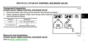

Hi,
Here’s a link to the Engine Mechanical section from the repair manual from the 2004 Nissan Quest repair manual.
Scroll to p.EM-47 to view the procedure to remove the front timing chain case.
At Step.28 on p.EM-50 the IVT control solenoid valves are removed.
Here is a link to all the various sections of the 2004 Nissan Quest repair manual some of which you may need to do the repair e.g at Step.2 in the procedure it refers to MA-14 draining engine coolant. This is to be found in the Maintenance section of the manual on page 14.
Here’s an image taken from p.EC-425 (Engine Control ) that shows how to test the solenoid which may be of some help.
(click on image to enlarge for better viewing)
It may be easier to use the manuals by downloading them to your computer. To do this when the relevant section has opened in the Document box, click on the Download icon (next to the Zoom 100% notice) either at the top or bottom of the page.
