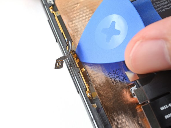

  32. Google Pixel Fold Fingerprint Sensor Replacement: 32 단계, 이미지 3개 중 1개 Google Pixel Fold Fingerprint Sensor Replacement: 32 단계, 이미지 3개 중 2개 Google Pixel Fold Fingerprint Sensor Replacement: 32 단계, 이미지 3개 중 3개
    • Use a spudger, or your fingers, to press down the conductive tape and adhere it.
    • Use tweezers, or your fingers, to pull on the tab and expose the tape.

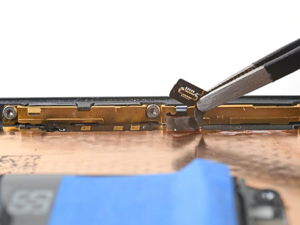

  33. Google Pixel Fold Fingerprint Sensor Replacement, Disconnect the ultra wideband antenna: 33 단계, 이미지 2개 중 1개 Google Pixel Fold Fingerprint Sensor Replacement, Disconnect the ultra wideband antenna: 33 단계, 이미지 2개 중 2개
    • If your graphite sheet is taped out of the way, remove the tape now.
    • Use the point of a spudger to pry up and disconnect the ultra wideband antenna press connector.

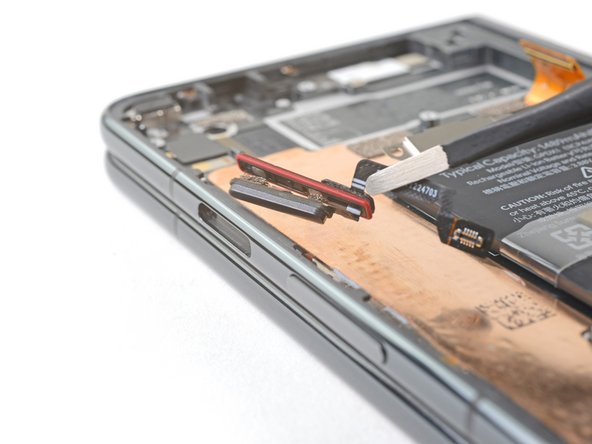

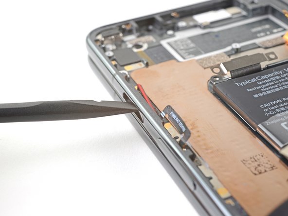

  34. Google Pixel Fold Fingerprint Sensor Replacement, Separate the adhesive: 34 단계, 이미지 2개 중 1개 Google Pixel Fold Fingerprint Sensor Replacement, Separate the adhesive: 34 단계, 이미지 2개 중 2개
    • The ultra wideband antenna is lightly adhered to the graphite sheet.
    • Slide an opening pick under the antenna to separate its adhesive.

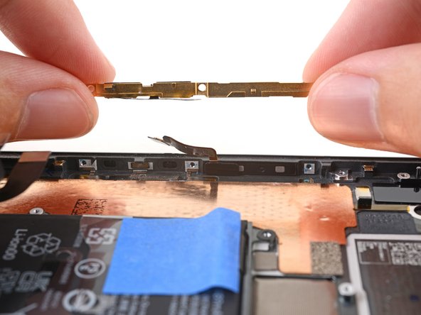

  35. Google Pixel Fold Fingerprint Sensor Replacement, Remove the ultra wideband antenna: 35 단계, 이미지 2개 중 1개 Google Pixel Fold Fingerprint Sensor Replacement, Remove the ultra wideband antenna: 35 단계, 이미지 2개 중 2개
    이 단계에 사용된 도구:
    Tesa 61395 Tape
    $5.99
    • Peel up the ultra wideband antenna and remove it.
    • During reassembly, if your adhesive is still sticky and intact, you can reuse it. Otherwise, follow this guide to replace it.

  61. Google Pixel Fold Fingerprint Sensor Replacement, Reposition the cable: 61 단계, 이미지 3개 중 1개 Google Pixel Fold Fingerprint Sensor Replacement, Reposition the cable: 61 단계, 이미지 3개 중 2개 Google Pixel Fold Fingerprint Sensor Replacement, Reposition the cable: 61 단계, 이미지 3개 중 3개
    • The fingerprint sensor cable is lightly adhered to the side of the frame.
    • Peel the fingerprint sensor cable away from the frame to separate the adhesive.
    • Move the cable over the left edge of the phone before continuing.
  62. Google Pixel Fold Fingerprint Sensor Replacement, Separate the adhesive: 62 단계, 이미지 2개 중 1개 Google Pixel Fold Fingerprint Sensor Replacement, Separate the adhesive: 62 단계, 이미지 2개 중 2개
    • The button bracket board is lightly adhered to the frame.
    • Slide an opening pick under the button bracket board to separate the adhesive.
    • During reassembly, be sure to position the board over its alignment pegs before resealing the adhesive.
  63. Google Pixel Fold Fingerprint Sensor Replacement, Unfasten the button bracket: 63 단계, 이미지 1개 중 1개
    • Use a Torx Plus 3IP screwdriver to remove the three 2.3 mm‑long screws securing the button bracket.
  64. Google Pixel Fold Fingerprint Sensor Replacement, Remove the button bracket: 64 단계, 이미지 3개 중 1개 Google Pixel Fold Fingerprint Sensor Replacement, Remove the button bracket: 64 단계, 이미지 3개 중 2개 Google Pixel Fold Fingerprint Sensor Replacement, Remove the button bracket: 64 단계, 이미지 3개 중 3개
    • Use the point of a spudger to pry the button bracket out of its recess in the frame.
    • Remove the button bracket.
  65. Google Pixel Fold Fingerprint Sensor Replacement, Remove the fingerprint sensor: 65 단계, 이미지 3개 중 1개 Google Pixel Fold Fingerprint Sensor Replacement, Remove the fingerprint sensor: 65 단계, 이미지 3개 중 2개 Google Pixel Fold Fingerprint Sensor Replacement, Remove the fingerprint sensor: 65 단계, 이미지 3개 중 3개
    • Use a spudger to push the fingerprint sensor out of its recess in the frame.
    • You may feel some resistance, as the fingerprint sensor is secured with a rubber gasket.
  66. Google Pixel Fold Fingerprint Sensor Replacement: 66 단계, 이미지 2개 중 1개 Google Pixel Fold Fingerprint Sensor Replacement: 66 단계, 이미지 2개 중 2개
    • Remove the fingerprint sensor.
    • During reassembly, insert the fingerprint sensor straight into its recess, not at an angle, before pressing the rubber gasket into place.
