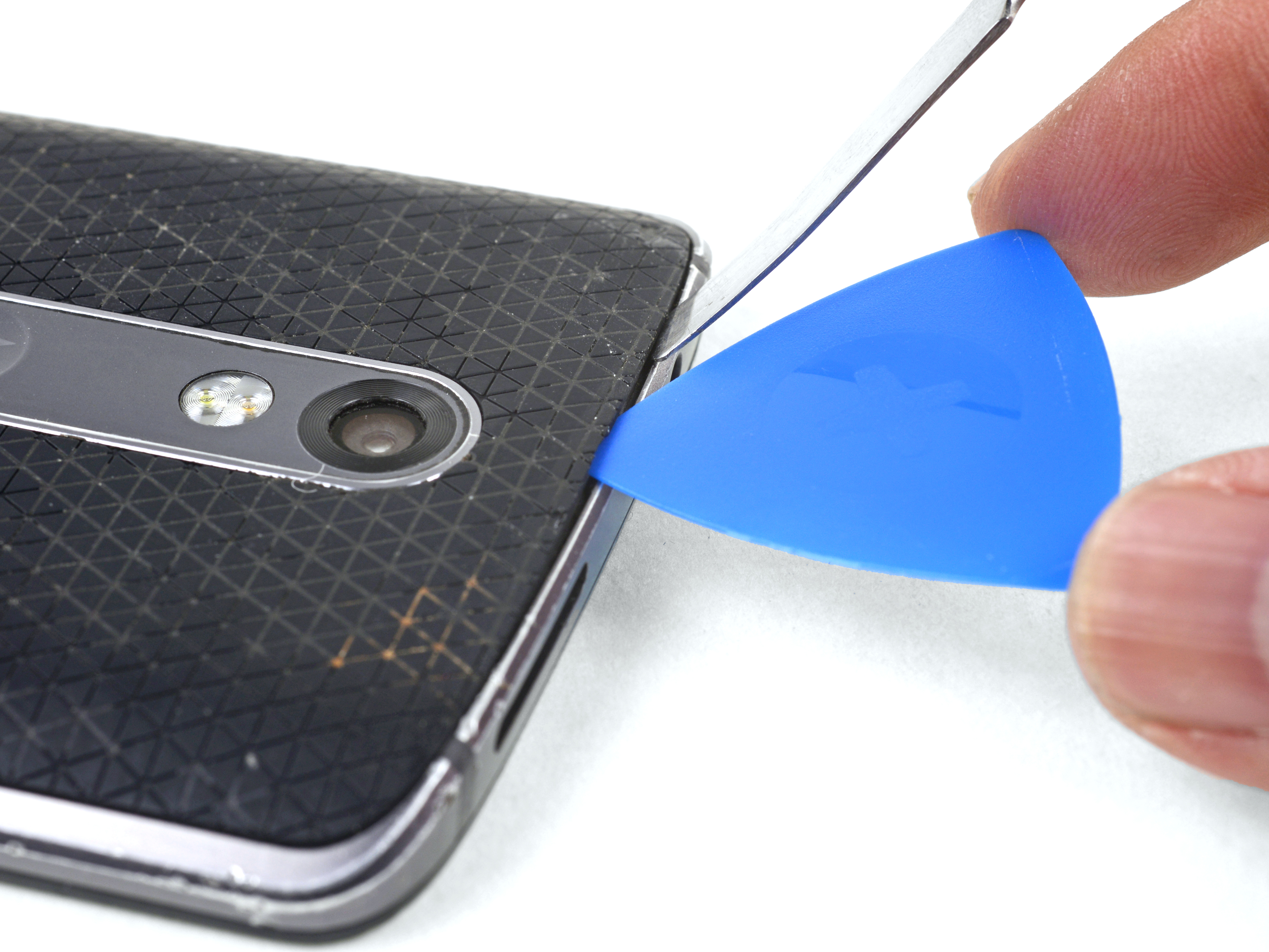

    • Angle an opening pick and firmly press so that it slips under the back cover.
    • Depending on the age of the phone, this can be difficult. Additional heating with the iOpener may help. You can pry carefully with a metal spudger to create a gap for the opening pick.

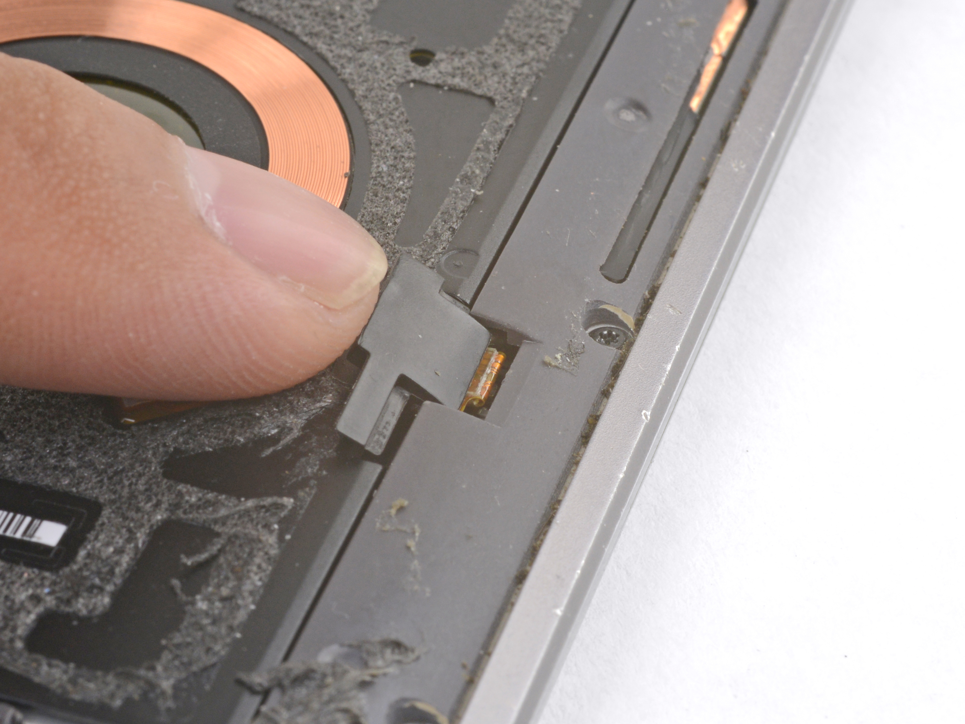

    • Insert an opening pick under the flash connector rubber cover and pry forward to remove it.
    • To reinstall the cover, align the cover and use your finger to push it forward into place.
    댓글 쓰기

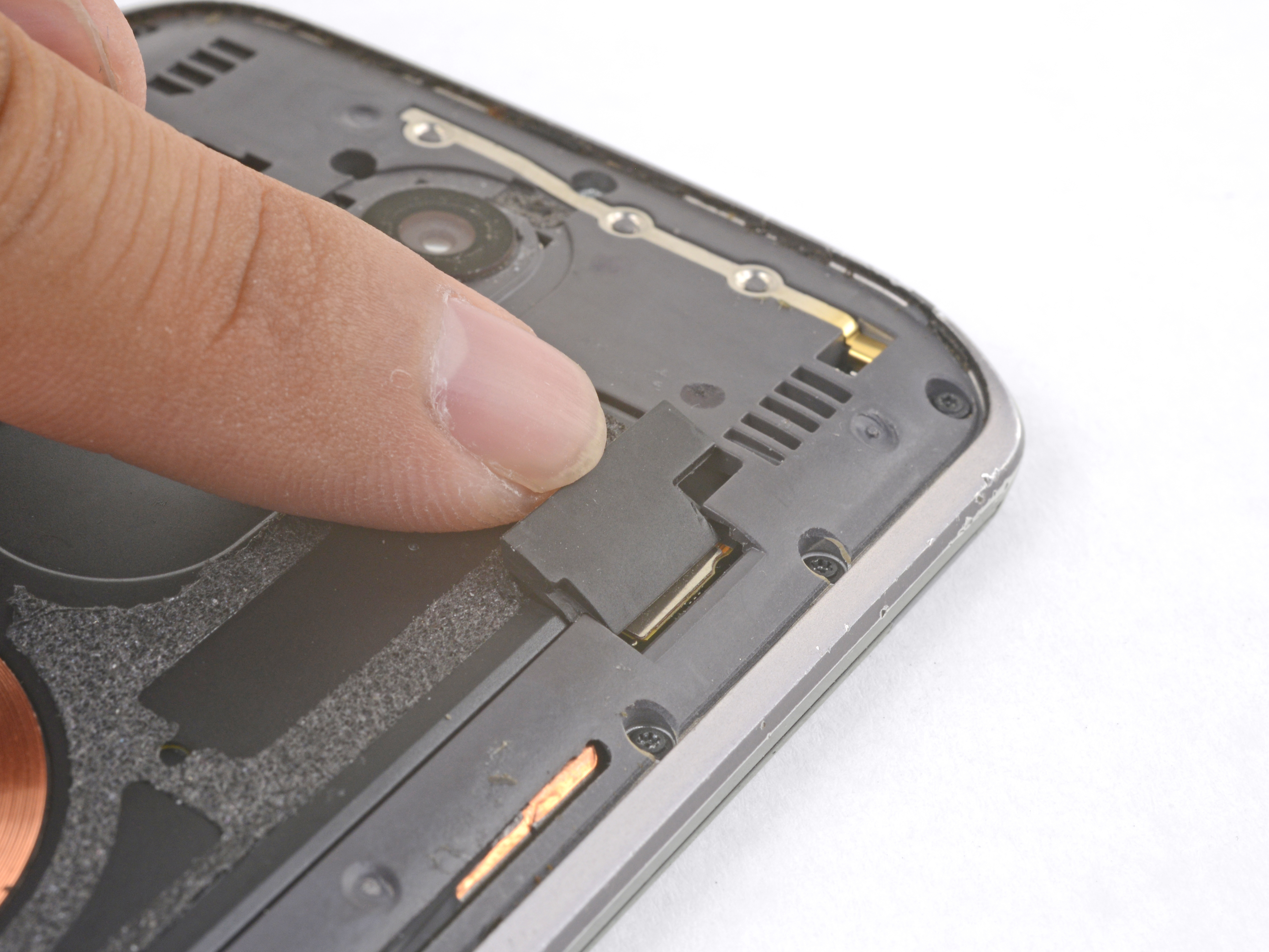

    • Use the point of a spudger to pry up and remove the coil connector rubber cover.
    댓글 쓰기
