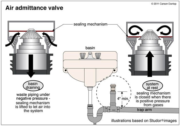

@arch It looks like whoever did this wanted only one p-trap but clearly didn’t install it properly. Also since there was no external venting available, they used an internal air admittance valve which is not a problem but it does require you to check it's functionality occasionally as that could also be a culprit (if everything seemed to work well before).
Example of how it works:
이미지
Photo provided courtesy of this site
Example of this valve is here: https://www.amazon.ca/gp/product/B0069KD...
Lastly, you know as everyone has told you, that slope is WAY wrong. Here is a sample photo of what it "should" look like:
