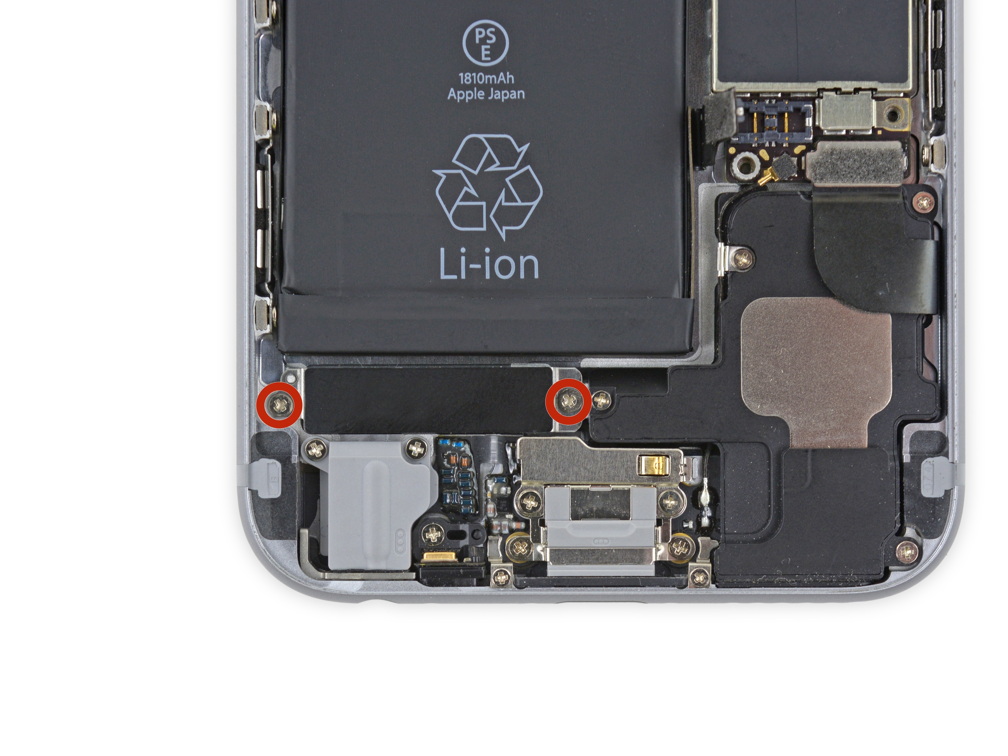

  24. iPhone 6 Volume Control Buttons Replacement, Volume Control Cable: 24 단계, 이미지 1개 중 1개
    • Remove the following Phillips #00 screws from the upper cable bracket:
    • One 2.9 mm screw
    • One 2.2 mm screw
    댓글 쓰기

    • Be gentle when peeling the thin portions of the cable up from the case.
    • Remove the volume control button cable from the rear case.
