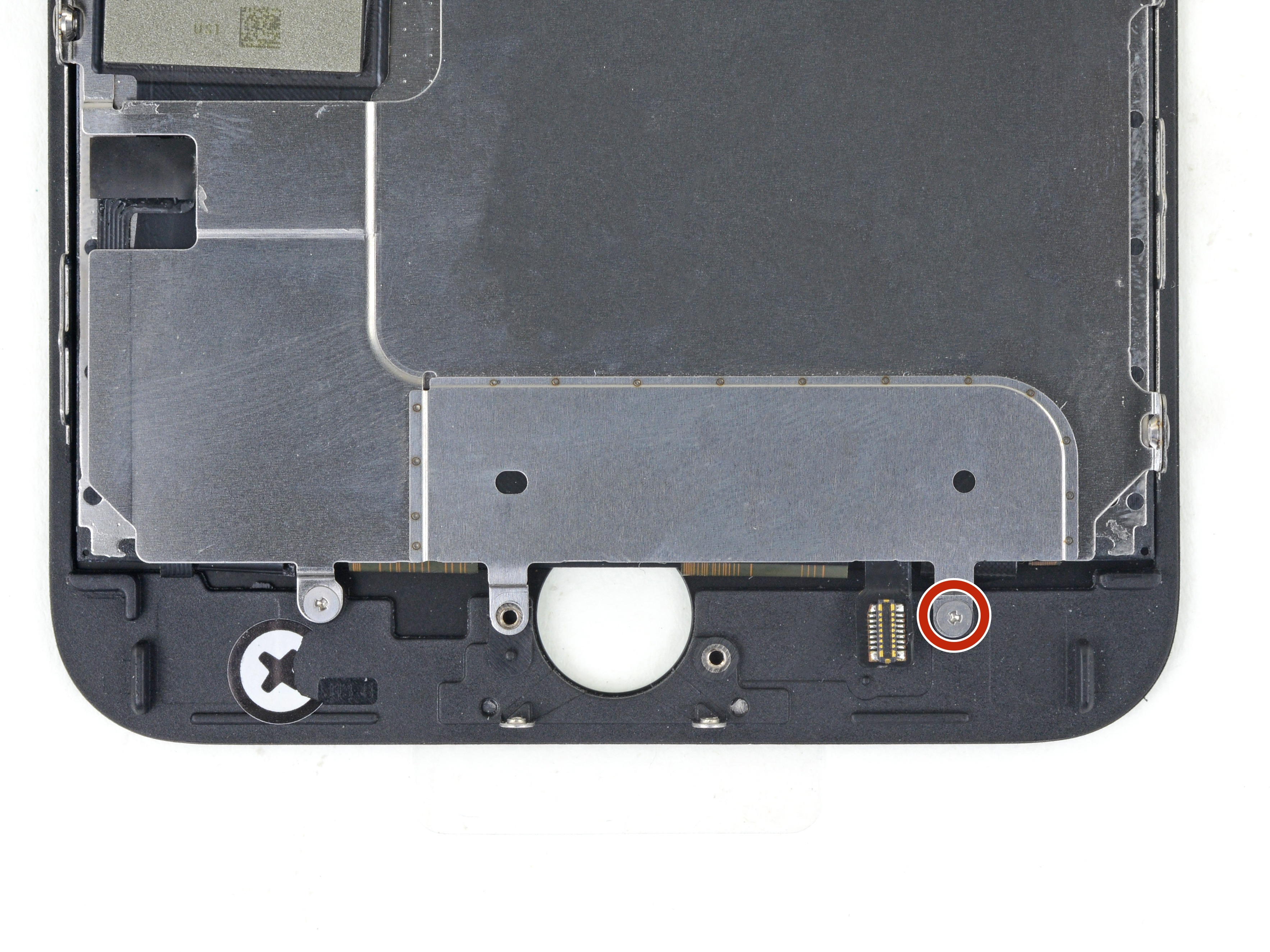

    1. iPhone 7 Plus LCD and Digitizer Replacement, Home/Touch ID Sensor: 35 단계, 이미지 1개 중 1개
      • Remove the four Y000 screws securing the bracket over the home/Touch ID sensor:
      • One 1.1 mm screw

Has anyone else had trouble getting the Y000 screws out from the bracket over the home/Touch ID sensor? All other Y000 came out no problem. These are fighting me. The driver seems to be spinning in place as if too big. Follow up question. If I strip these screws, any idea how to get them out then?
jferguson757 - 답글 공유
In my situation the Y screw behind the Home/Fingerprint Button seems to be GLUED ON by design to prevent inexperienced non-certified Apple replacers to remove it. So what I did was left it on to prevent stripping the screw and breaking the button. I just CAREFULLY BENT the metal bracket AT AN ANGLE so that I can maneuver the whole assembly into the hole of the screen and remove it.
Eric Vengeance - 답글 공유
