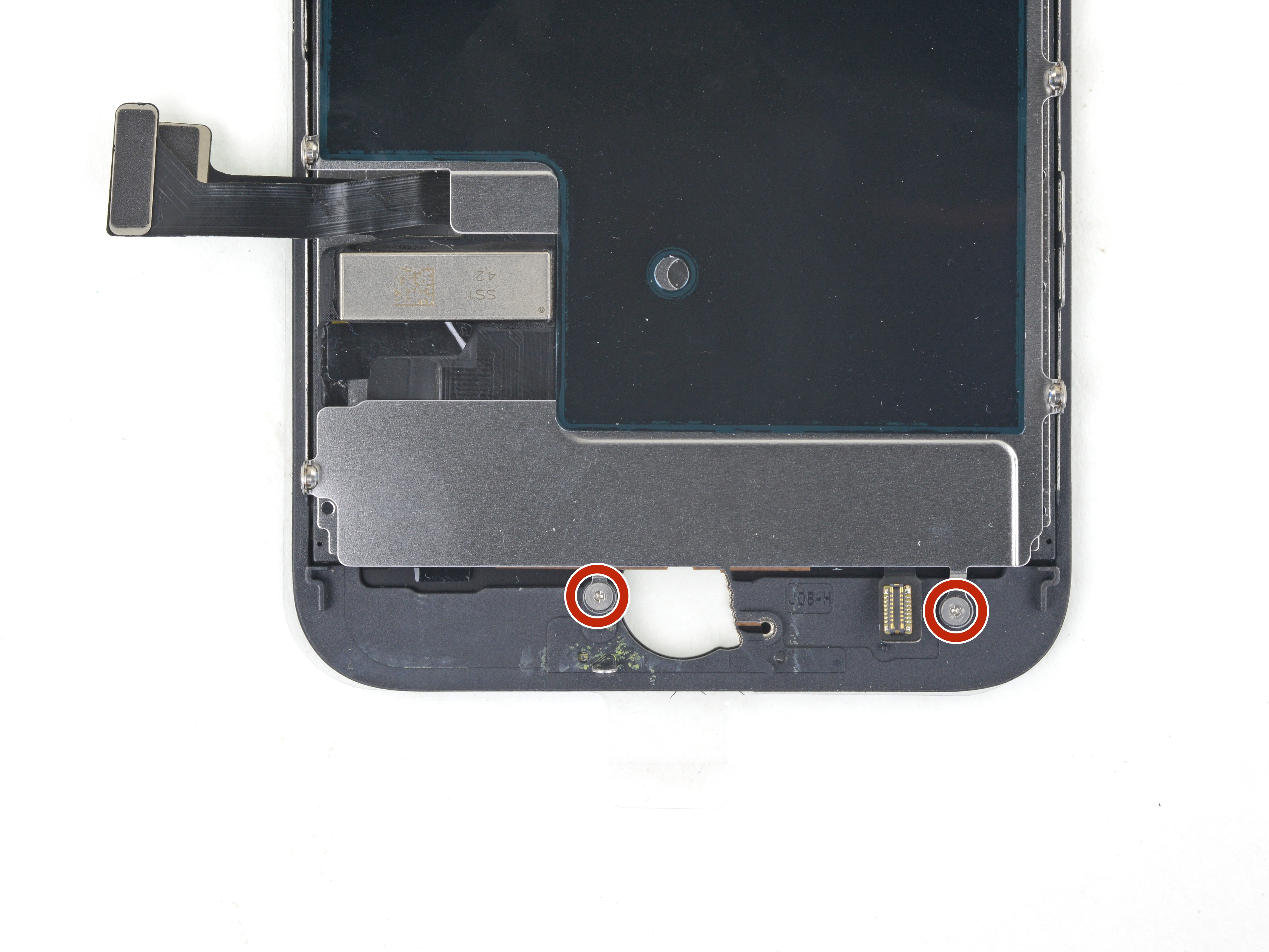

  23. iPhone SE 2020 Screen Replacement, Remove the home/Touch ID sensor bracket: 23 단계, 이미지 2개 중 1개 iPhone SE 2020 Screen Replacement, Remove the home/Touch ID sensor bracket: 23 단계, 이미지 2개 중 2개
    • Remove the four Y000 screws securing the bracket over the home/Touch ID sensor:
    • One 1.2 mm screw
    • Remove this screw first. Excess pressure may bend the home button bracket if you remove the 1.3mm screws first.
    • Three 1.3 mm screws
    • Remove the bracket.
    • During reassembly, be careful not to overtighten these screws, or your home button may not work.

  25. iPhone SE 2020 Screen Replacement, Remove the Touch ID sensor: 25 단계, 이미지 1개 중 1개
    • Heating the area around the home/Touch ID sensor will help soften the adhesive holding its delicate cable in place, making it easier to remove safely.
    • Flip the display assembly over. Use a hairdryer or prepare an iOpener and apply it to the lower edge of the display for about 90 seconds in order to soften up the adhesive underneath.
    • Don't overheat the display. It should be slightly too hot to touch comfortably.
